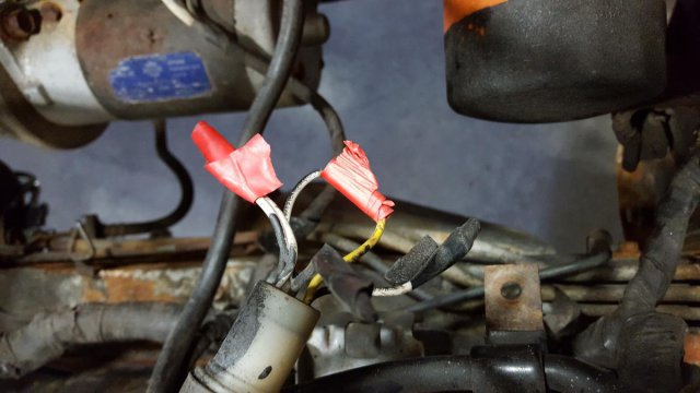

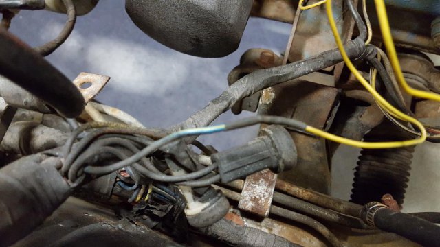

mforget Posted April 9, 2017 Share Posted April 9, 2017 (edited) Hi, i am currently restoring a 280z. The engine runs great but i found several wires cutted/disconnected. I would need some help to identify them. Blue/yellow wire on first picture. And all the wires on the second picture plug. Thanks in advance! Edited April 9, 2017 by mforget Quote Link to comment Share on other sites More sharing options...
KevvinG Posted April 9, 2017 Share Posted April 9, 2017 (edited) If you could take the pictures from a bit farther away it would help to get an idea of what we're looking at. On the second picture that looks like it's the wiring that would normally go to the mechanical voltage regulator. It's a common upgrade to change to the 280ZX internally regulated alternator, when you do that you need to bypass the old voltage regulator by jumping the two wires that are taped off. I've done that on my car and it's great. There should be a pretty big black box type thing on the passenger side between the strut tower and the battery area, if that's removed then you know you've got the ZX alternator mod. Edited April 9, 2017 by KevvinG Quote Link to comment Share on other sites More sharing options...
mforget Posted April 9, 2017 Author Share Posted April 9, 2017 If you could take the pictures from a bit farther away it would help to get an idea of what we're looking at. On the second picture that looks like it's the wiring that would normally go to the mechanical voltage regulator. It's a common upgrade to change to the 280ZX internally regulated alternator, when you do that you need to bypass the old voltage regulator by jumping the two wires that are taped off. I've done that on my car and it's great. There should be a pretty big black box type thing on the passenger side between the strut tower and the battery area, if that's removed then you know you've got the ZX alternator mod. Hey, great infos there! Ill go back to the car and take a look at this! I will also take another picture farther away for the other blue/yellow wire. Its near the same place as the regulator wires, passenger side, a little more toward the front of the car..... Quote Link to comment Share on other sites More sharing options...

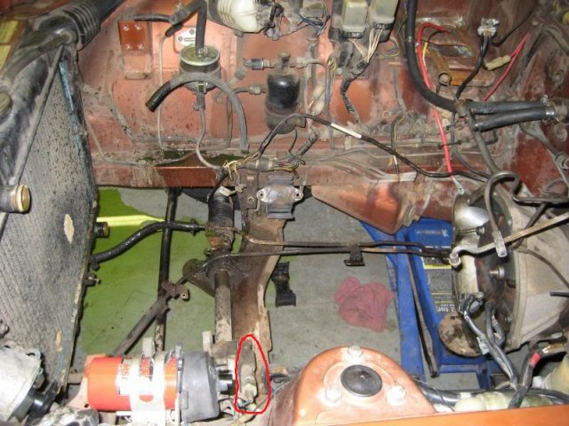

mforget Posted April 11, 2017 Author Share Posted April 11, 2017 Also, what is that thing circled in red on that picture? I just found that blue wire disconnected on my car.... Thanks a lot! Quote Link to comment Share on other sites More sharing options...
