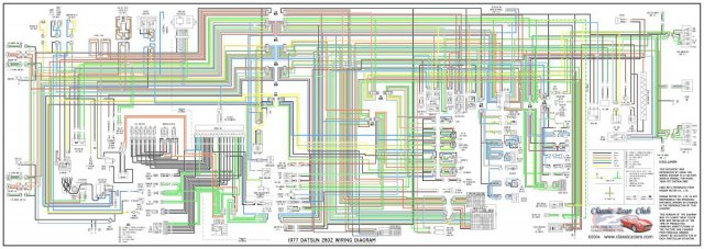

  1. Good thing there is a place for 4 spare fuses at the base of the panel. Anyone else see any problem with the circuitry before I start soldering it together?
  2. NewZed: Pretty sure the starter wiring is correct. Thanks for the compliment. I'm a graphic artist. I drew the layout then cleaned up a scan and added the words with Photoshop. ZHoob2004: I'm thinking the same way as you on the oil pressure switch. The switch pressure is adjustable and default is 5 lbs so should not be a problem when starting. The power for ignition is coming from the key switch. The power for the push button is coming from a fused 12v circuit (cig lighter that is already wired to that location) and is only exciting the relay. Thanks for your reply.
  3. I've been a member here for 13 years and have probably read every post (twice). Now I have a bunch of questions so I tried to wrap them all up into one big question with the use of a wiring diagram. Would someone with good wiring knowledge please look over my drawing and advise me if it’s OK as is or what needs to be changed. Thanks guys! 1977 Datsun 280Z Restomod 2005 L33 Chevy 5.3L V8 Motor Carb Manifold with MSD Ignition
