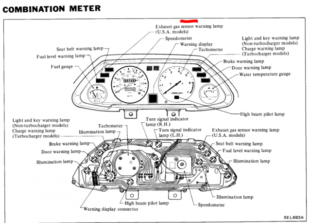

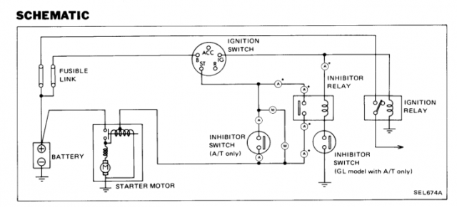

NewZed Posted June 23, 2017 Share Posted June 23, 2017 Have you tried jumping the starter solenoid wire at the starter? Have a mechanic check your starter. When you turn the key to Start do the dash lights stay on or does everything turn off? Is the "sensor light" the exhaust gas sensor lamp? That's the only "sensor light" I see. Is it a Turbo car with ECCS, or NA with the EFI system? Two different systems. The NA car does not have a brain and the ECCS brain is abbynormal. Neither will shut down the engine, I believe. Too many possibilities, hence the need for more detail. Quote Link to comment Share on other sites More sharing options...
