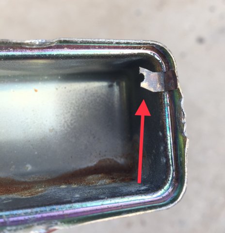

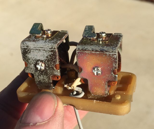

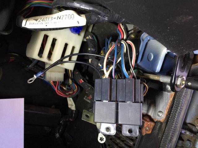

D9inger Posted January 13, 2018 Share Posted January 13, 2018 (edited) turns out it was the relay, unmounted it and with it plugged up still and a ground added to the mount bracket I noticed it was intermittent. So I did a quick search and discovered they are not available anywhere. Figuring I had nothing to loose I straightened the tabs and removed the cover and found the ground strap was broken. I tried adding a ground by drilling a small hole in between the relays and soldering the coil grounds to it but I think I had tired 40 year old relays in addition to the broken ground strap. I got to looking for solutions and found this along with information of people offering relay harness adapters for sale and links to the 6 pin non locking connector. The ready made ones were $75-80 delivered, the 6 pin connector was $3 and another $35 for the crimper I was getting ready to cut the OEM connector off and splice in a set of relays and decided to see if I could get the relay contacts to release from the OEM connector. A dental pick and some patience and I was able to get them to release and they are exactly the same size as the ones in the new relay sockets. So one at a time I removed and reinstalled the OEM wires and connectors into the new relays sockets, checked everything with my meter, added a terminal end to the black grounds and plugged in the relays. Works, not expensive and with the exception of the relay sockets, no new connections to fail. As an added bonus the holes line up with the originals so remounting was a breeze. Edited January 13, 2018 by D9inger added pictures Quote Link to comment Share on other sites More sharing options...
NewZed Posted January 13, 2018 Share Posted January 13, 2018 That is some nice detective work, and solution. Do you have the info on the replacement relay? They don't last forever, I have a dead one sitting in front of me right now. Luckily, my car came with a spare. Quote Link to comment Share on other sites More sharing options...

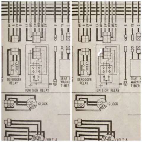

D9inger Posted January 13, 2018 Share Posted January 13, 2018 (edited) Thank You, I did discover the 1978 FSM schematic was incorrect too. It won't work like they drew it and the wiring in the car confirmed it. The giveaway was the top left pin on the drawing had 2 wires in it and nothing in the bottom left. There was one wire in each on my car. The one on the left is original, the one on the right is corrected. I used standard Bosch relays, I bought a 10 pack off ebay. I had to do the headlight mod earlier and figured I'd need them. http://forums.hybridz.org/topic/127971-led-headlight-bulbs-anyone-tried-them/?tab=comments#comment-1196144 Dave Edited January 13, 2018 by D9inger . Quote Link to comment Share on other sites More sharing options...

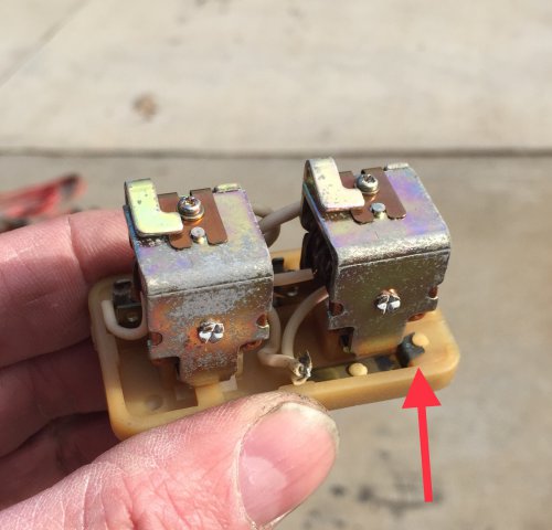

NewZed Posted January 13, 2018 Share Posted January 13, 2018 Could be worse. Here's the one that came out of my car, a 1976 model. The one in front of me now is actually my EFI relay, I was mixed up on my last post. Thanks for the tip on the wiring diagram. Quote Link to comment Share on other sites More sharing options...
D9inger Posted January 13, 2018 Share Posted January 13, 2018 Wow... Did that get wet or something? Quote Link to comment Share on other sites More sharing options...
NewZed Posted January 13, 2018 Share Posted January 13, 2018 That area is where the water drains down if it gets through the windshield, and the car is angled a certain way. The car has water marks under the passenger seat from the puddle that sat there for while. Only the Accessory relay didn't work though. The PO had a jumper wire ran up to the ignition switch for that. Quote Link to comment Share on other sites More sharing options...
