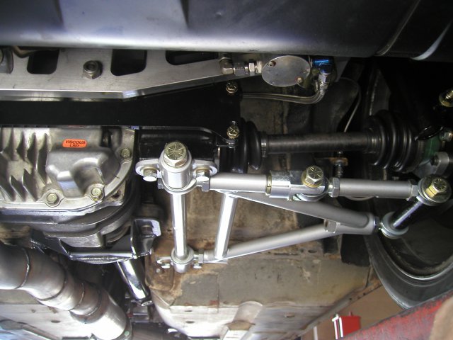

Mike Mileski Posted October 31, 2017 Share Posted October 31, 2017 (edited) I used a TTT kit to mount an R230 in my '71 240Z and, because I made my own rear control arms using heim joints on the inner pivots, I was able to lower the inner portion of the rear arm by about 1/8" so it cleared the axle shaft. I also had to mount the top of the R230 diff only about .030" below the rear crossmember to make everything work. I ordered my aluminum mustache bar without the two diff mount holes so I could drill them myself. It's worked fine for several years. I have another '71 Z that I plan on doing the same thing to. See the attached picture. I put 1/8" thick washers under the tabs that mount the rear inner arm to lower it. 1/8" is too small an amount to cause any negative effects on suspension issues. I've had zero issues. Mike Mileski Tucson, AZ Edited October 31, 2017 by Mike Mileski Quote Link to comment Share on other sites More sharing options...
