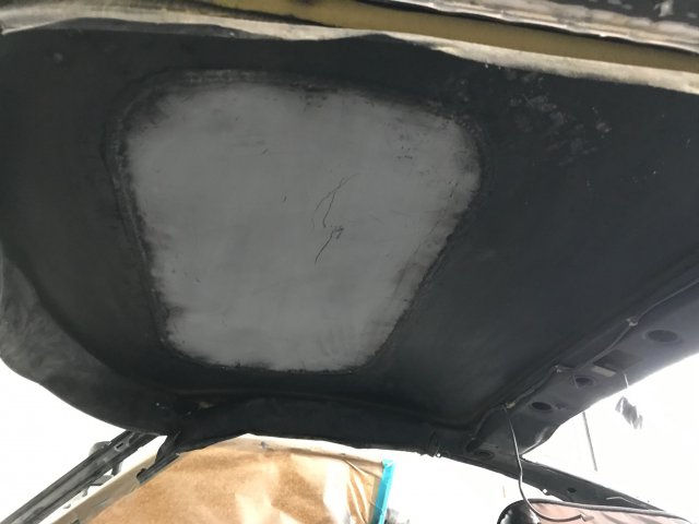

On 10/27/2017 at 8:02 PM, davz75_280z said:
Sorry I'm new to this but decided to make a thread of my 280z progress.I bought it with a sunroof and have decided to patch it up
This is how it looked like before.
So the first thing I did was try to get the actual sunroof piece out.
After started cutting right under that line where the roof met the sunroof
IMG_20171027_133838.thumb.jpg.0dbd988980d59b43c485662c6b006928.jpgIMG_20171027_134550.thumb.jpg.c6ca01932124e18eb7d4fc8c38f6bc68.jpg
 Now all I gotta do is grind, make everything straight and patch up a new piece to cover the hole👌
Sorry for very little detail I took too little pictures. Will try to do better next time

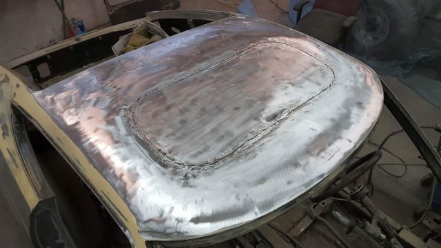

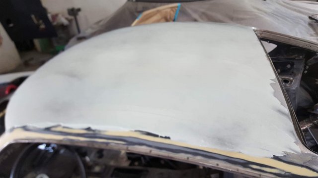

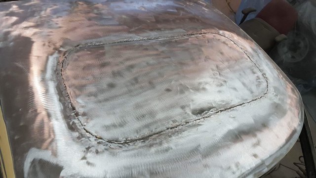

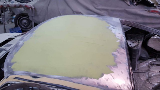

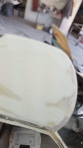

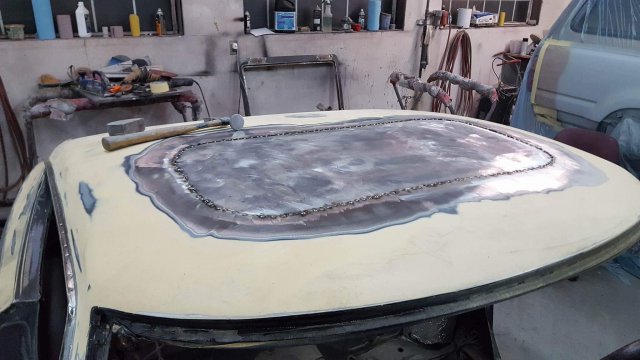

I removed it, Removing was Easy....
Dollying it out and getting the welds perfect..LOTS of work!!!
Ended up skimming the roof like 3 times to get it perfect!  Super happy with the result but damn I wish I bought one without a sunroof LOL...
