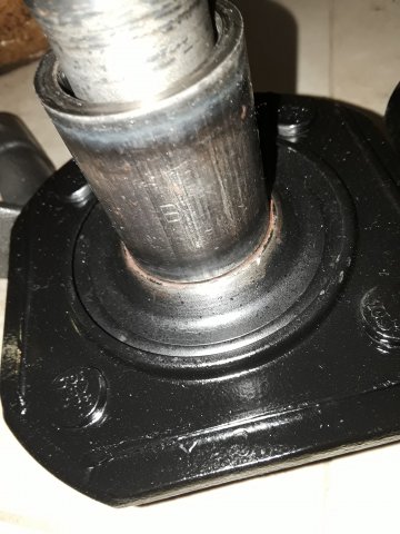

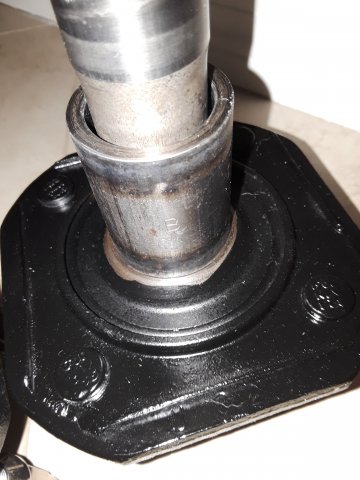

The letter on the spacer has to match the letter stamped on the hub casting. Assuming that  the casting is original, look around the  hub casting (see picture). Once you have the correct spacer, assemble the spacers and bearings per the FSM for the year strut you have.
