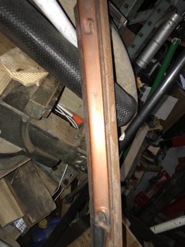

calZ Posted August 26, 2018 Share Posted August 26, 2018 I'm interested in fitting a set of the plastic a-pillar and head rail trims that came on on the 280 in 1977-78. I can see that the a-pillar trims mount with just two screws, but I haven't been able to find a picture or see in-person how the mounting screws attach to the pillar. If there are simply holes in the metal, that's easily replicable on a 240z. If there are standoffs, that gets a bit more finicky. Does anyone know offhand or have a picture/car they could show me to answer the question? Quote Link to comment Share on other sites More sharing options...
ritrebor Posted August 27, 2018 Share Posted August 27, 2018 Just slots. ritrebor Quote Link to comment Share on other sites More sharing options...
calZ Posted August 27, 2018 Author Share Posted August 27, 2018 39 minutes ago, ritrebor said: Just slots. ritrebor Thanks! It looks like the slots are on slightly raised bosses. Is that right? Quote Link to comment Share on other sites More sharing options...
ritrebor Posted August 27, 2018 Share Posted August 27, 2018 Top is sunken and bottom is raised ritrebor Quote Link to comment Share on other sites More sharing options...
