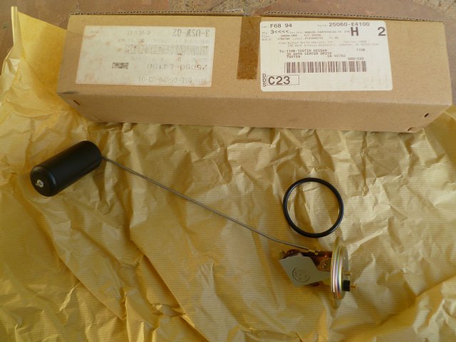

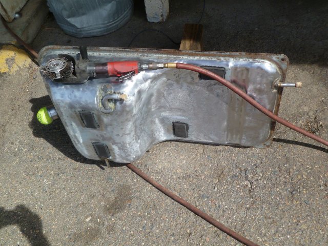

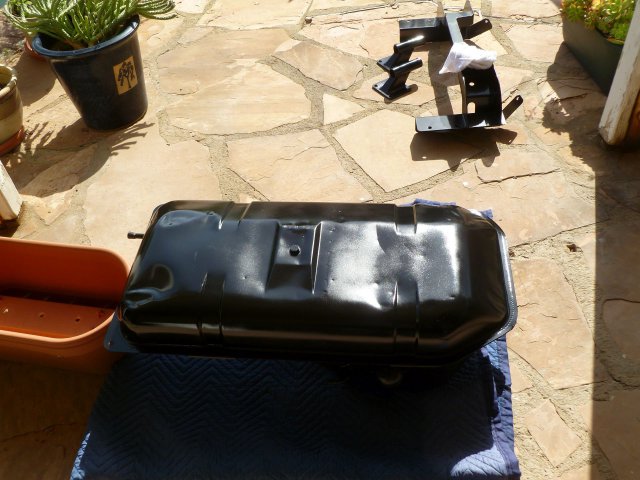

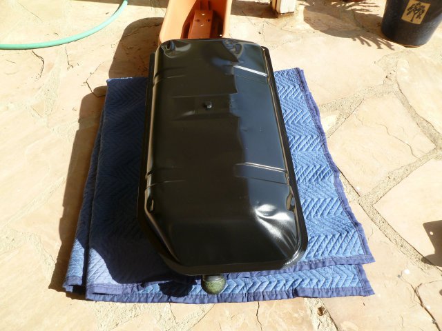

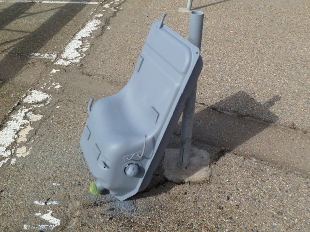

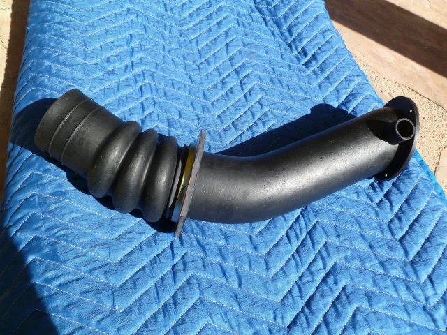

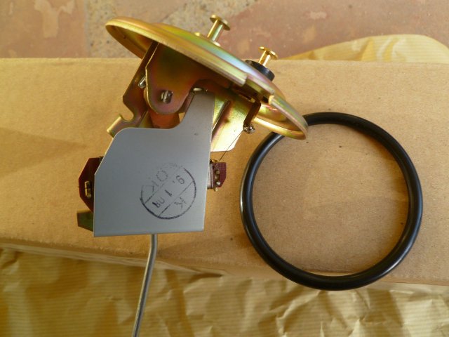

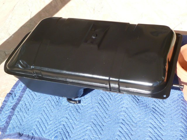

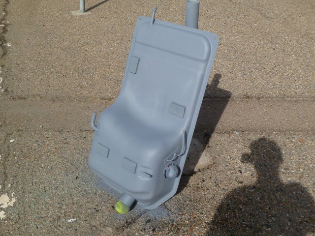

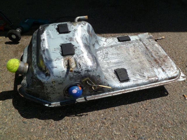

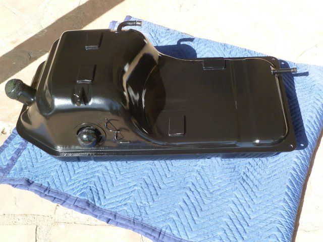

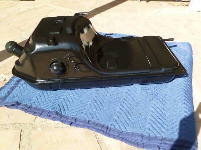

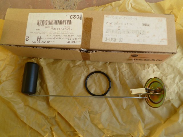

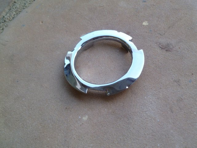

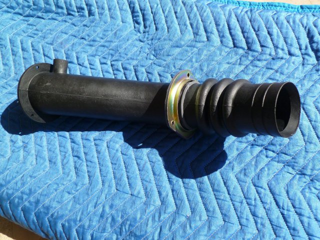

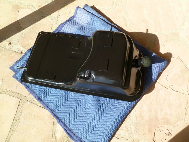

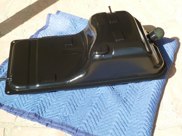

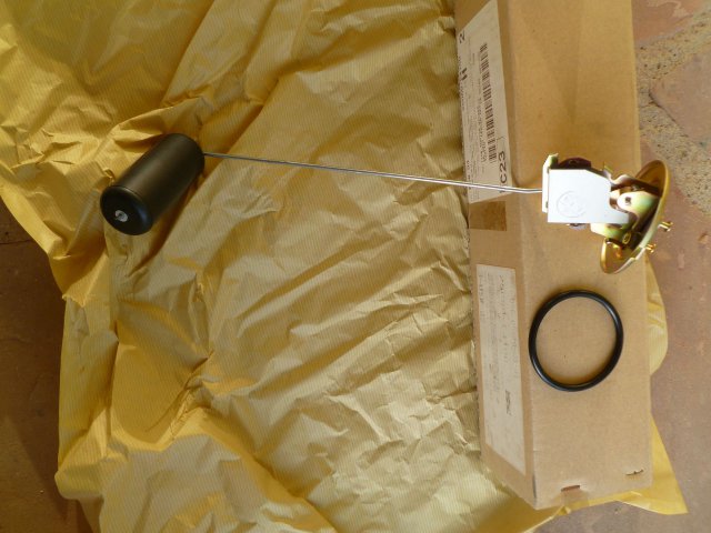

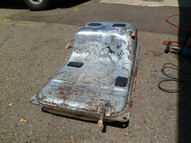

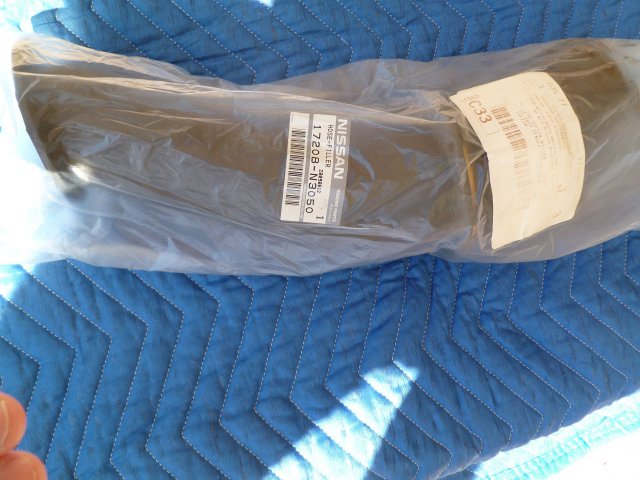

I have my stock '73 tank out and it has been hot tanked a long while ago as I was going to do custom work cutting and welding on it. It sat foir a long while in storage and had a light layer of rust in it until I bought a bunch of Evaporust and the largest Rubbermade storage container that it would fit in. I plugged all the lines and holes and continuously turned and let it sit for over two weeks, (lot of re-taping effort spent on getting all sides). I got the inside of the tank to shine like new, but instead of coating it with any oil substance I let it dry and was supposed to sell it locally , but the guy flaked out. It now has the thinnest layer of flash rust in it, but another soak of the Evaporust will take it right back off.  I stripped the paint off down to bare metal then primered, then painted an amateur job with quality rattle cans. I also have a new fuel filler neck and sending unit from MSA that I am not using as I will be installing a fuel cell.
