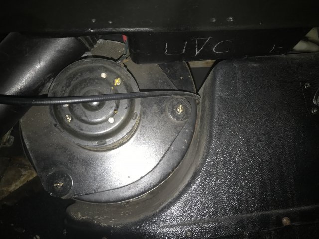

trying to help my kid get some heat in the cabin, '72 240.  Chevy 350zz4. Has some flavor of dealer installed A/C.  So, turning on the fan we get air through the center and two side vents but nothing to the floor or defroster, I assume the A/C system's fan replaces the OEM one? So what directs air where?

BTW, from your picture....that is the stock blower, so it does not appear that the AC modifications replaced the OEM blower with an aftermarket blower.
Really?  I have lots to learn apparently.  I assumed that was the A/C blower.  Okay so there's a flap inoperative.  I think it maybe right behind the center vent (well, deeper in near #6 here:

The same blower is used for heat, fresh air, defrost and AC (even on dealer-installed AC systems).
You may possibly have two flaps inoperative, if you are getting neither heat in the footwells nor defrost on the windshield.
