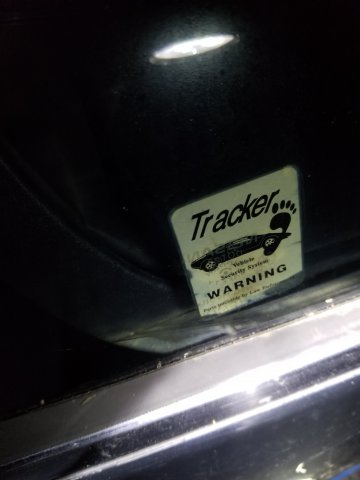

5 Star Rising Posted January 4, 2019 Author Share Posted January 4, 2019 Anyone know anything about this theft system? Could it be why this car wont start? Can't find this decal online to find the manufacturer. Looks like a old sticker. Wonder if there is something planted in this car for security. Quote Link to comment Share on other sites More sharing options...
260DET Posted December 24, 2020 Share Posted December 24, 2020 (edited) That Tracker system may have more to do with GPS tracking of the car's location? Otherwise you seem to be on top of things, for a start I'd assume that there is no engine fault other than that caused by inactivity, like dirty spark plugs or fouled injectors. Good luck with it. Edit LOL, look at the date. Edited December 24, 2020 by 260DET Quote Link to comment Share on other sites More sharing options...
DREW RBZ Posted December 27, 2020 Share Posted December 27, 2020 Old thread but could also be a bogus sticker to make believe there is a "tracker" system. Quote Link to comment Share on other sites More sharing options...
