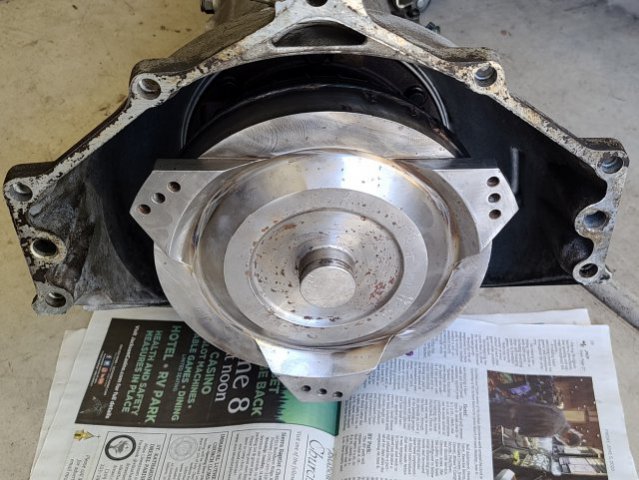

A turbo LS was always the plan, but it eventually evolved into twins. A Powerglide was also the initial transmission selected, but after a decent 4L80e was found for $100, I decided to go that route. Added a HD2 kit and all seals for good measure. Converter is a no name 10" billet from a truck I had, but it kept smoking lockup clutches, so the last time it was repaired under warranty, it became a shelf piece while my truck got a billet Pro Truck Yank Triple Ciutch.
