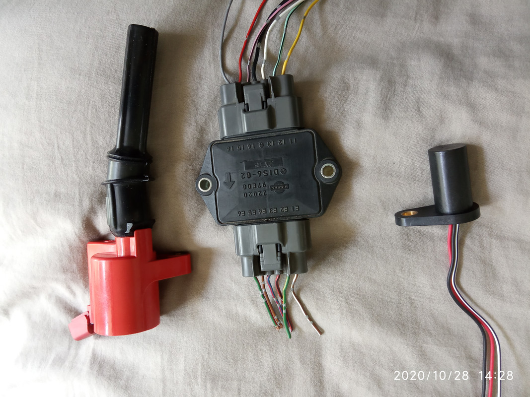

This is what I have gathered to achieve this goal :
36-1 trigger wheel fitted to crank pulley
3 wires Hall sensor
DIS6-02 igniter from a 300ZX (or similar)
Ford coil on plugs (DG-508)
My question is : what needs to be done to my MS2 ECU in order to upgrade it to be able to control spark while using a 36-1 trigger wheel (wasted spark).
The MS ECU was purchased built to order with a fuel only setup in mind, so the components to control spark would need to be added (hardware, firmware upgrade?).
Any pointers, good write-up?
Thanks
Cheers
Simon
Edited by 2s2mad
Link to comment
Hi, you have to reopen your ecu and be sure  your ignition out is wired, and you'll need some IGBT 's  to control wasted sparks , with your cops ( are you sure your 300 zx ignitor is useful ? )
read the ms extra manual , every thing is avalaible .
with a 36-1trigger wheel , you put 50 degres in the soft  TS
