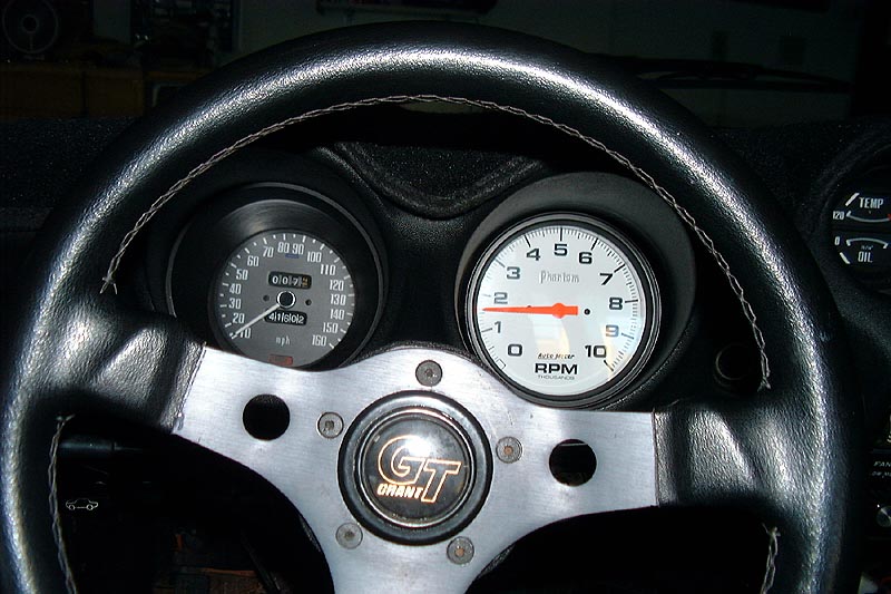

Guest ON3GO Posted June 27, 2003 Share Posted June 27, 2003 BLKMGK.. you have any pics of your tack and shift light? thanks. Quote Link to comment Share on other sites More sharing options...
BLKMGK Posted June 29, 2003 Share Posted June 29, 2003 Ya' on my site. http://www.blkmgk.com in the Pictures section. Not sure the lite shows up but it's on top of the dash back up near the windshield. http://www.blkmgk.com/Development/TestWEB.nsf/4691e0edd8a01bd6852569ae0075e9c4/53f86e3bc6debea785256a74005dc350!OpenDocument I used LEDs for turn signal and high beam indicators... Quote Link to comment Share on other sites More sharing options...
