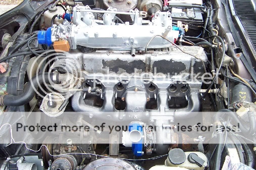

Guest znow white Posted June 5, 2004 Share Posted June 5, 2004 i had 81tzx that got stripped with a shot turbo. I also have another 82tzx engine that im using for parts which i took the turbo for my swap I thought it was watercooled because of those two nipples so i was asking a zedder friend the same thing i put them both together and they were for the waste gate and actuator i I thought it was water cooled duhhhh IM STILL NOT SURE I WILL TAKE A PIC RIGHT NOW! EDIT: I got pics where can i upload for free and good bandwith? Quote Link to comment Share on other sites More sharing options...
MaTTSuN Posted June 6, 2004 Author Share Posted June 6, 2004 there for the waste gate? i have the same plastic tube's they bend down so that wouldnt make sence if it was for water? i wonder how it works for the waste gate? i guess ill just block them off since my old one doesnt have them..... :Matt Quote Link to comment Share on other sites More sharing options...
Guest znow white Posted June 6, 2004 Share Posted June 6, 2004 ok i think i confused you my bad when you said centre housing I thought you said collector housing because there are 2 90 degree plastic tubes (mine were a lil broken and show a lil metal) those are vacuum lines to control the waste to open and shut for boost DONT clog those you will fry ur turbo or worse your engine. in my gallery I will upload a pic of 2 oil cooled t3's next two each other the one attached to the manifold (left) has no waste gate or vac lines hooked up. the other one has the vac lines attached and a waste gate. but you cant see the other line its covered anyways it goes to a T and attaches to the waste gate. gallery Quote Link to comment Share on other sites More sharing options...
