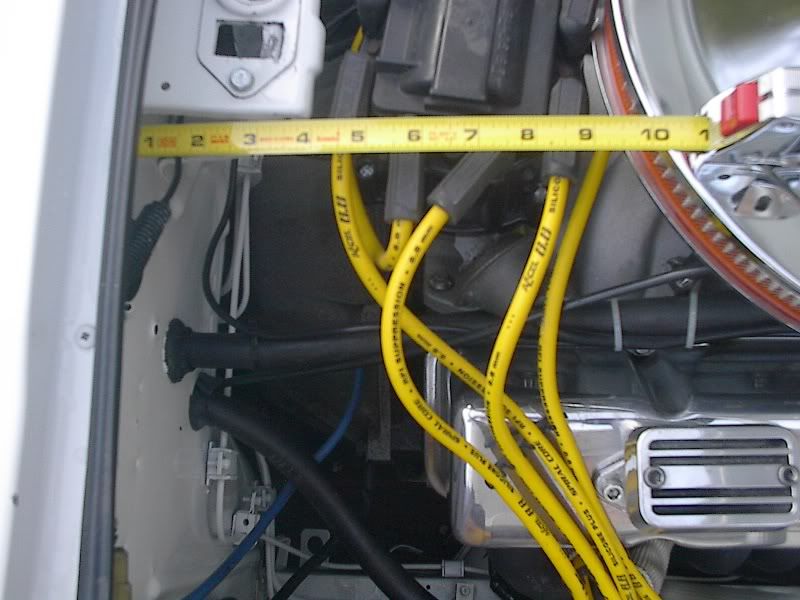

V8240Z Posted July 14, 2008 Share Posted July 14, 2008 My first post. I recently bought my first V8Z and I am having lots of confusion with the engine position. One thing I know; it's not the JTR position after reading so many threads and buying the JTR manual. This is my fifth Z car and I currently have a 71 240Z with a 280ZX and triple carbs. Lets get back to the questions: The distributor is 6 inches away from the firewall and have enough clearance to use the stock hood latch mechanism and also use a full size air filter. The car has a heavy custom frame made of square tubing and an x that is welded across the frame for rigidity. The frame is well constructed, it will add weight to the rear to help with weight distribution. Because of the welded x frame, I may have a hard time putting a straight exhaust system if I decide to replace the side pipes. The car came with bad engine but movable and a TH350 tranny. I already swap the motor with a 71 chevy Impala. After the swap, it seems like I did some damage to my tranny and it get stuck on drive, but I am able to start the car which definitely tell me there is a safety switch issue also. I can move the car forward by pressing hard on the gas pedal and I can push it back when I turn the ignition off while still on D. My plan is to swap the TH350 for a WCT5 which I already bought. Before I start spending more money, I would like to know if the position of the motor will make it impossible to use the T5 since the JTR manual says: with the Scarab position the T5 shifter will be in the fusebox hole. I read other threads that say the T5 is a couple inches longer than the TH350. If the T5 is longer than the TH350, I think it should fit except if the tailstock and the bellhousing of the T5 are shorter than the TH350. As I mention before, I have a T5 and bellhousing from an 87 Camaro. Thanks in advance for you help. Quote Link to comment Share on other sites More sharing options...

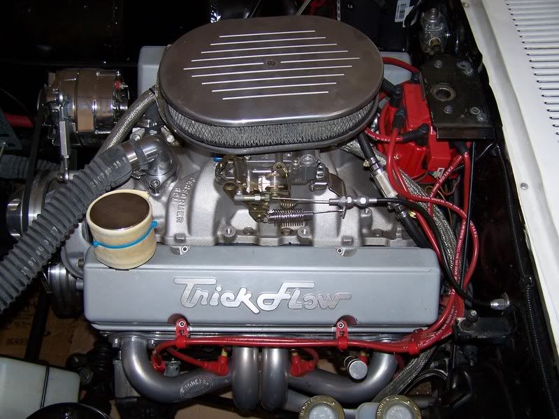

dsommer Posted July 14, 2008 Share Posted July 14, 2008 Scarab mounting position. JTR MOUNTING POSITION Quote Link to comment Share on other sites More sharing options...
V8240Z Posted July 15, 2008 Share Posted July 15, 2008 Thanks for the advise and the pictures. As I can see, in the Scarab position, the engine is not place in the same position. One of the picture shows the distributor is like 5 1/4' away from the firewall while mine is 6' away. The previous owner who is a mechanic told me that the car handle very well while it was running. Maybe the heavy duty square tubing in the rear really help with the weight distribution. I'll give him a call to see if handling was not an issue at all. I haven't have a chance to drive it yet after the engine swap because of the tranny issue and it's not registered yet. the rear has 245/60/14 and the front has 195/60/14. I think I am going to play with the TH350 tranny or get it repair to see if I can get it on the road. After that, I'll decide about moving the engine to JTR position. I really don't want to spend the money fixing the automatic tranny and change to manual later. Scarab mounting position. JTR MOUNTING POSITION Quote Link to comment Share on other sites More sharing options...
