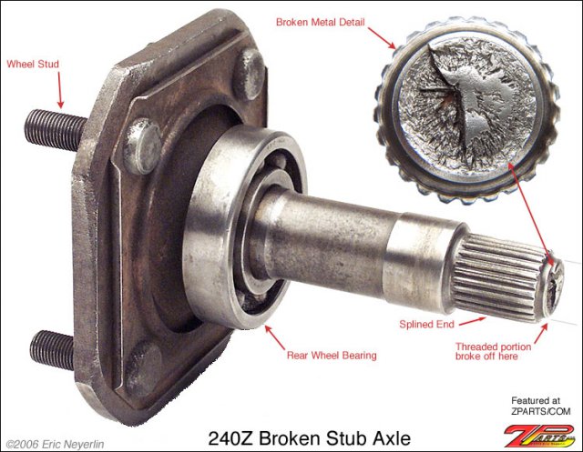

Question for Miles:  How did those chequered... stub axles worked out?  Are they used in any kind of competition?  For now, I am using the remaining one of my original 240z stub axles that I've had magnafluxed and one refurbished 240z stub axle bought from the Z Store.   I could not find any 280z stubs on short notice.
The Chequered stub axles installed and fit perfectly. No they are not used in competition. I have had stock stub axles break under normal daily driving as in the attached picture.  The Chequered axles will probably outlast the car.
