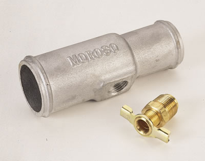

80LS1T Posted July 11, 2005 Share Posted July 11, 2005 The fitting on my LT1 thermostat housing is 1 1/4" and the fitting on my Griffin radiator is about 1 3/4"(I think its actually a little smaller but 1 3/4" will work). So I need a reducer to put in between the two different size hoses plus I need to be able to install a small outlet for the vent hose coming off the back of the heads! So I have to be able to either weld that piece in, braze it in, or drill a hole and tap it for a fitting. So does anybody know where I can get something like this? I am going to look in the plumbing section at Menards tomorrow to see what I can come up with but I am a little doubtful that I will find what I need. Guy Quote Link to comment Share on other sites More sharing options...

Tim240z Posted July 11, 2005 Share Posted July 11, 2005 http://store.summitracing.com/partdetail.asp?autofilter=1&Ntt=moroso+radiator&N=303575&part=MOR%2D63700&autoview=sku&Ntk=KeywordSearch Quote Link to comment Share on other sites More sharing options...
80LS1T Posted July 11, 2005 Author Share Posted July 11, 2005 Tim you are the man! That is exactly what I need and its pretty cheap, only $14! I tried to find it on Summits site but I guess I didnt punch in the right search words. Guy Quote Link to comment Share on other sites More sharing options...
