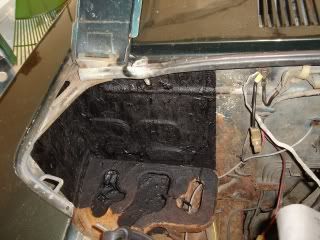

I'm sure all of you worry a little when you see how badly rusted the area around your battery is, from all of the corrosive gases it gives off. My battery box actually rusted through in 2 places, which I patched using some sheet steel. To keep it from rusting further, I painted the entire area with a thick coat of fibrous roofing pitch, as shown below.
