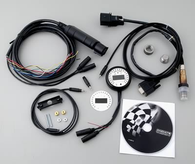

proxlamus© Posted March 2, 2006 Author Share Posted March 2, 2006 whoohoo.. Austin showed me the Summit clearance kit.. $215 for Standalone Gauge Kit, LC-1 Wideband Controller, XD-1 Programmable White Face Gauge, Bosch 5-wire O2, Bung/Plug Accurate air/fuel readings you can see from the drivers side. These Innovate XD-1 programmable digital gauges features programmable LED colors and remote control button to start and stop the Innovate LM-1 log sessions or initiate calibration. They are a mere .750 inches thick, so it's possible to mount even in surface mount configurations. The display features a 3 character central LED display, remote control button, and a programmable digital needle. The body is a billet aluminum bezel. * Additional Info 46% off, Clearance * Clearance o WARNING! Due to extremely limited quantities, some products may no longer be available. A Customer Service representative will contact you if there's a problem. Soo.. I get a guage too! whoo hoo Quote Link to comment Share on other sites More sharing options...
