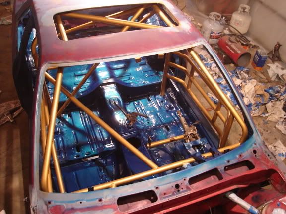

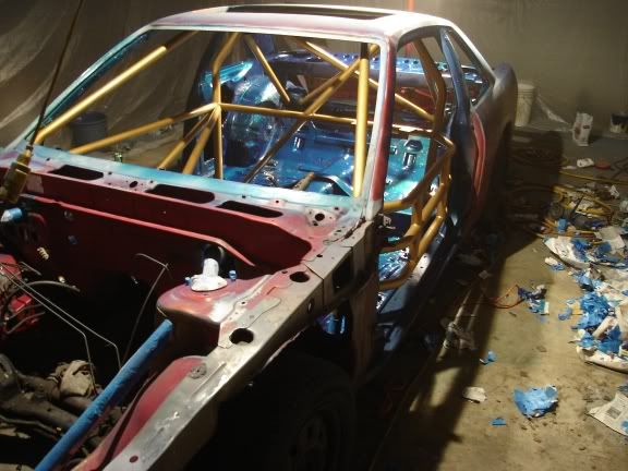

well here is where i am right now the flanges will def be cold rolled and the tubes will most probably havent set in stone but 304 sched 40 will no doubt hold the heat, also it has low heat transfer wich in turn makes exhuast gas flow faster through it.I have been fabricating for abotu 5 years and my partner has been at it for about 25 years so there is no worry there
"Stainless grade 304 is an excelent choice--easily welded, crack resistant, and relativley east to work with" direct quote from maximum boost written by corky bell
here are some pics of a cage i put in a scca racecar

That's pipe. Use tube.
i would rather over build it than use liek sched 10 and have them underbuilt and crack
