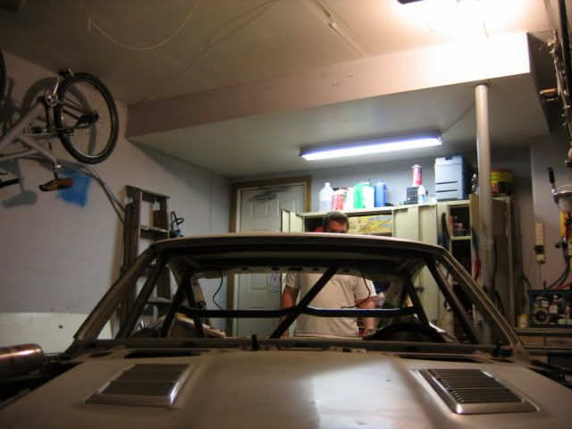

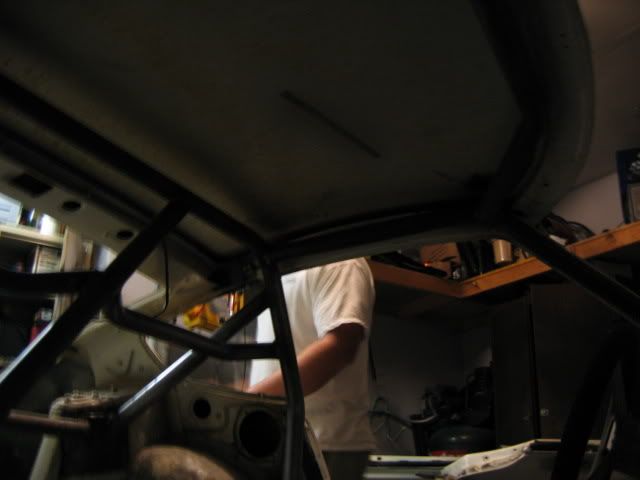

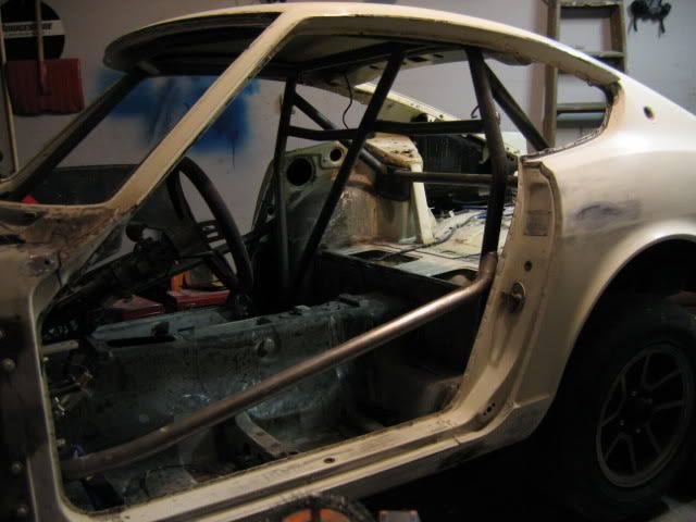

Guest dherde26 Posted May 11, 2006 Share Posted May 11, 2006 tell me what you all think... Quote Link to comment Share on other sites More sharing options...

johnc Posted May 11, 2006 Share Posted May 11, 2006 Although you most likely won't be questioned at an open track event, SCCA and NASA normally won't allow unsupported door bars. Quote Link to comment Share on other sites More sharing options...
Guest dherde26 Posted May 11, 2006 Share Posted May 11, 2006 Although you most likely won't be questioned at an open track event, SCCA and NASA normally won't allow unsupported door bars. what do u mean by unsuported Quote Link to comment Share on other sites More sharing options...
johnc Posted May 11, 2006 Share Posted May 11, 2006 Oops! Never mind, the first image hadn't completely loaded (I'm on dial-up) so it appeared to me that there wasn't a front hoop and you had built a NHRA type 6 point roll bar. Your cage looks fine. Quote Link to comment Share on other sites More sharing options...
JMortensen Posted May 11, 2006 Share Posted May 11, 2006 The one thing I'll say is that it looks like the hoop is about 4 or 5 inches farther forward than it needs to be. I'd be curious to see if when you're seat if your head is all the way in front of the hoop. You had better pad it up good if there is any chance of your head coming in contact with the hoop. Quote Link to comment Share on other sites More sharing options...

katman Posted May 14, 2006 Share Posted May 14, 2006 The horizontals in the main hoop should be at the kinks in the main hoop, not above them, but otherwise not too shabby. Quote Link to comment Share on other sites More sharing options...
Guest dherde26 Posted May 14, 2006 Share Posted May 14, 2006 The horizontals in the main hoop should be at the kinks in the main hoop, not above them, but otherwise not too shabby. i agree with you but then that puts the harnesses a shade bit low... hey i posted in the shock thread kinda hopin you would see it ...if u would take a look and let me know i would apreciate it thanks drew Quote Link to comment Share on other sites More sharing options...
