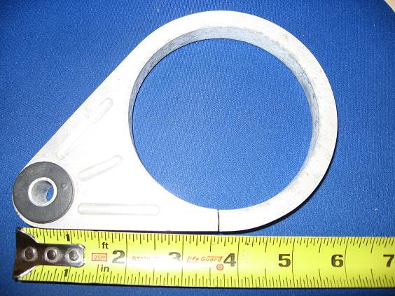

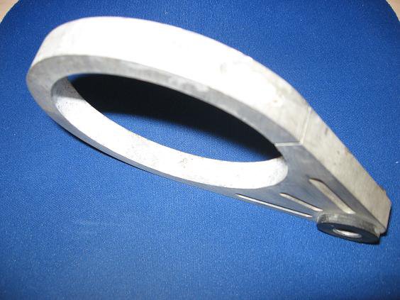

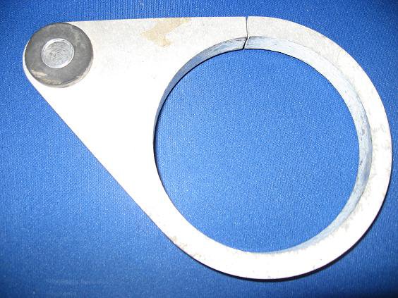

Datsun350Z Posted September 6, 2006 Share Posted September 6, 2006 I just got a stack of old paperwork from the last owner of my car. There are a few papers that are from hooker that seem to be a V8 conversion kit. Did this exist, or is it something else that just mentions v8 conversion, like headers for the swap? I also have an early 90's Arizona Z car brochure with a few products I didn't know about. I'll also scan pages of that if anyone is interested. Bonus question: what is this? 4 of them were mailed to me with the paperwork, and no description. Quote Link to comment Share on other sites More sharing options...

Mike kZ Posted September 7, 2006 Share Posted September 7, 2006 Those things in your pics look like exhaust hangers Quote Link to comment Share on other sites More sharing options...
Datsun350Z Posted September 7, 2006 Author Share Posted September 7, 2006 They do look like they could be, but the diameter is 3.5" on the inside, and it also seems like it would rattle like crazy... unless it's missing a rubber gasket (1/4 inch thick) on the inside which would fit a 3" exhaust. Those things in your pics look like exhaust hangers Rags: I'd still like to check out your car, do you have any free time this weekend? I need some motivation to get some real work done on my Z. That way I don't have to tow it to your garage if you have a get-together Quote Link to comment Share on other sites More sharing options...
DavyZ Posted September 8, 2006 Share Posted September 8, 2006 The kit from Hooker is the same as the old Scarab conversion. It places the engine much farther forward and up higher than the Jags That Run (JTR) kit. IMHO the JTR conversion is far superior. Yes, I agree that overall the JTR conversion is superior, but for all out drag racing like JNJ do, I don't think it will make that much of a difference actually. Mikekz: BINGO! They sure do look like exhaust hangers. Davy Quote Link to comment Share on other sites More sharing options...
