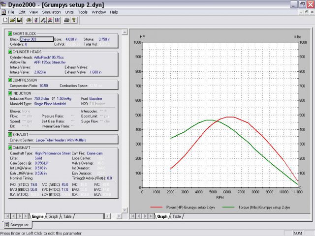

could one of you computer literate gentelmen post a DD-2000 on that combo with the new AFR flow numbers and the rest of the specs

"could one of you computer literate gentelmen post a DD-2000 on that combo with the new AFR flow numbers and the rest of the specs".
Here it is. 486hp@6000 463tq@4500
