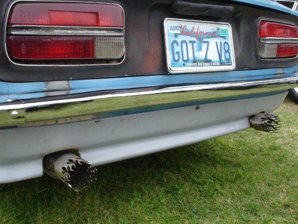

Your other option is to use a gas tank from a different vehicle. Myself and a few others used nylon tanks form LS1 f-bodies, and Dan Juday used one from a Suzuki Samurai.
Edit: I added a pic of my duals. I know some people don't like the tips, but my kids like it and it works for me as well.
Hey Bartman, my plan was to put pipes exiting about where you bumper is. Do gas tank swaps provide enough clearance for that. Is the measurments for said tanks in the archives?
I don't have measurements off hand, but I think it would work. My mufflers are sort of an oblong shape with the exhaust exiting on the bottom. You could either get a mufler with a center exit to raise it up some, or turn it 180 degrees to have the exit at the top.
