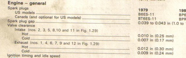

Noddle Posted December 13, 2006 Share Posted December 13, 2006 When adjusting the valves, do you have the lob straight up from the rocker to adjust, or have the cam lobes in there V position (per cylinder) to adjust ? see pictures Nigel Quote Link to comment Share on other sites More sharing options...
roger.svoboda Posted December 13, 2006 Share Posted December 13, 2006 the rocker has to be on the part of the cam that is not part of the lobe. the whole purpose is to give some lost motion so that when the linkages ectc. heat up to operating temperature it assures that the valve is not being held open when on the non lobe portion of the cam. If you set them when the rocker is on the lobe it will not open the valve fully. Quote Link to comment Share on other sites More sharing options...
Guest EVLZX Posted December 13, 2006 Share Posted December 13, 2006 Here are some pics that were sent to me when I did my adjustments. Quote Link to comment Share on other sites More sharing options...
Noddle Posted December 13, 2006 Author Share Posted December 13, 2006 EVLZX said: Here are some pics that were sent to me when I did my adjustments. [ATTACH]1876[/ATTACH] [ATTACH]1877[/ATTACH] Thanks for that, Nigel Quote Link to comment Share on other sites More sharing options...
