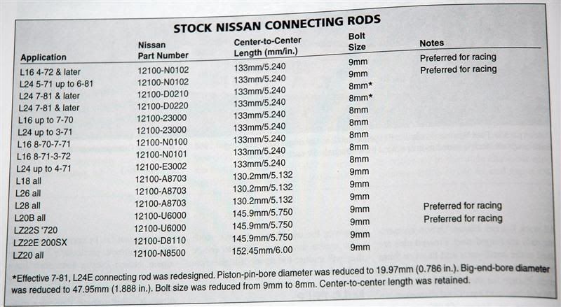

Courtesy of the “How to modify your NISSAN and DATSUN OHC” book written by Frank Honsowetz… I have no idea “how” accurate this is… (I hope I’m not stepping on any toes “copy right” wise by posting this…)
