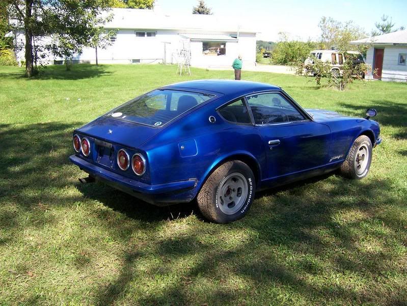

76s30 Posted March 24, 2007 Share Posted March 24, 2007 Let me take this opportunity to introduce my self. My name is Jake, I live in Green bay. One of the cars I currently own is a 76 fairlady Z I saved from a barn other than the lower core support its clean. it was originaly brittish racing green (looks about that color under the carpert) now its a blue that looks sorta like the 350z color. (painted before I found it) When I found it it had dead mice in the HAVC system, it was dirty and other than paint and maybe the mirrors (they are power, still on the fenders though) it was original. The fuel injection system was in/op faulty ecu I believe. The fuel lines leaked every where The clutch was in/op I replaced the clutch, removed the fuel injection system wraped and boxed it. installed triple 40mm phh mikuni's MSA "stage 3" cam, and the correct lash pads. MSA 6 into 1 header 2 1/2 " exhaust Magnaflow SS muffler Holley fuel pump inplace of stock hi pressure efi pump and a regulator. well under 3500 it ran like poop, due inpart that the carbs were set up for a 2.8 with same cam. rejetted it, and ran good.Took the car to the family afair for Thanks Giving, on the way home I put it in 2nd not 4th (doh) floated a valve. Now its almost Z driving season again here. If I'm rebuilding an engine its going to be a 2.8 N/A for now with room to turbo later. so my question to whom as ever been kind enough to read this far, is are 40mm phh to small with an N42 head stage 3 cam on a 2.8 I would like to make 170 -180 whp. I'm afaird that the 2.8 will run out of breath on the top end with 40mm carbs, are my suspisions true? Thank you Quote Link to comment Share on other sites More sharing options...

greenmonster80 Posted March 25, 2007 Share Posted March 25, 2007 Sweet car. Love the skyline tail lights, JDM bumpers and the early style front end. L20A motor will rev really well, but I ditched mine for the L28 as well. Nice find you definitely saved a keeper. Quote Link to comment Share on other sites More sharing options...

76s30 Posted March 26, 2007 Author Share Posted March 26, 2007 the tail lights were acutaly a kit sold by a company called "IMPACT PARTS" they were based out of NYC that kit was sold in the late 80's early 90's I don't know how ever what vehicle they actually sourced the lights from, but they made the fiberglass rear filler panel. again they were installed when I found it and they are ultra rare and I kinda like um so there they stay. A little more info about the car, when i was going through it I found the original wheel stops still sealed in the plastic bags they came in. and some emission testing papers from 4/84, 10/85, 7/86, but they are in japenese, I'll try and snap some pics of um if you would like to see. There also a U.S. forces Japan sticker on the windshield just above the rear view mirror, assumably from the serviceman who owned it back in the day and was nice enough to bring it home with him. Sorry savageskaterkid unless your going to finish my 3 other projects for me no Quote Link to comment Share on other sites More sharing options...
