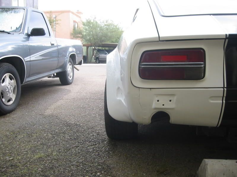

toki Posted April 1, 2007 Share Posted April 1, 2007 Well I bought this car with flares already on it, but I have no idea what they are, how much wider over factory they are supposed to be/are, etc. I don't know how many companies out there make mold in flares for the s30, but any help would be appreciated. and that is not a dent or relief on the lower part, just an odd reflection. Thanks, Ryan Quote Link to comment Share on other sites More sharing options...

JMortensen Posted April 5, 2007 Share Posted April 5, 2007 Since you're asking for opinions, I have one I'll share. The flare should be convex instead of concave. I think they do that for appearance's sake, but the problem is that there isn't that much room for the tire to move up inside the flare. That said, if it doesn't rub then don't worry about it. Quote Link to comment Share on other sites More sharing options...
toki Posted April 6, 2007 Author Share Posted April 6, 2007 So do you forsee any problems shoving a 17x11 with a 275 out back there? I will obviously take measurements for myself once I get the suspension put back on, but it's going to be GC coilovers with 8" springs. Quote Link to comment Share on other sites More sharing options...
JMortensen Posted April 6, 2007 Share Posted April 6, 2007 It's going to be close. What I'd suggest is you remove a spring and jack the current wheel up and down and measure for clearance before you spend $$$ on the new rims and tires. Quote Link to comment Share on other sites More sharing options...
