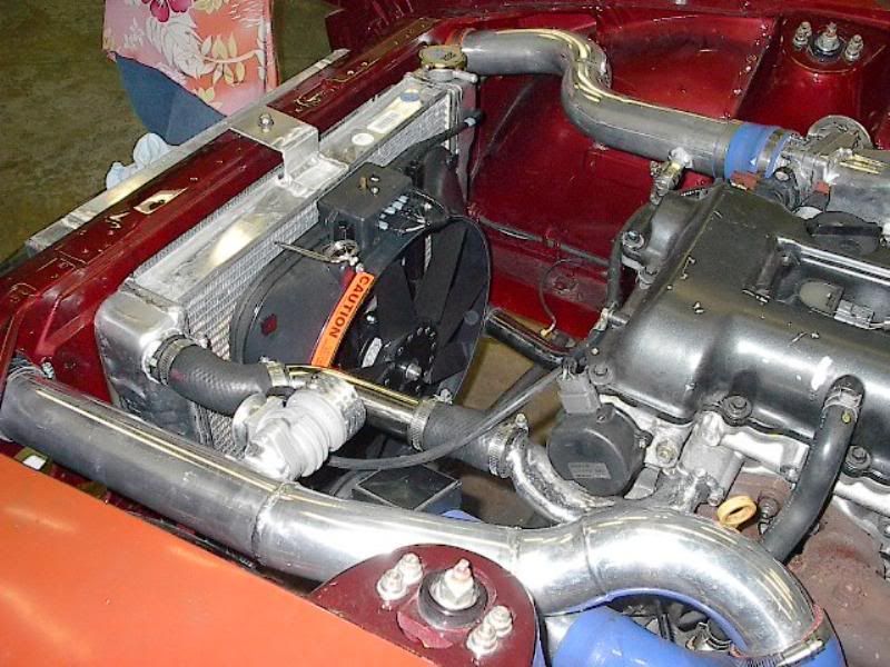

Sr-FairladyZ Posted May 2, 2007 Share Posted May 2, 2007 Hey fellow SR-Z friends . Heres how I went about my Sr20 driveshaft install. Luckly enough a buddy just got an SR that still had the yolk attached to the trans (as mine did not). Prior to installing the SR I got to work putting in my 4.11 R200 in . So now I used the yolk from the SR and the shaft from a Z31. Took pics of the mesurements and took that to my local 4X4 driveshaft shop. They welded me up a real nice and balanced shaft for $90 . It looks like a freak'n axel its so damn short. So yes. you really need to cut and have it welded. This was one of the easier fabrications of the project. Hope this helps anyone out there. Quote Link to comment Share on other sites More sharing options...
Sr-FairladyZ Posted May 2, 2007 Share Posted May 2, 2007 Also you want the engine as far back to the firewall as possable to really entertain the fact that you now have a mid engine car Quote Link to comment Share on other sites More sharing options...
