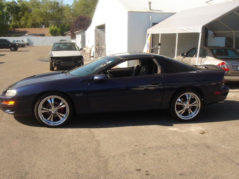

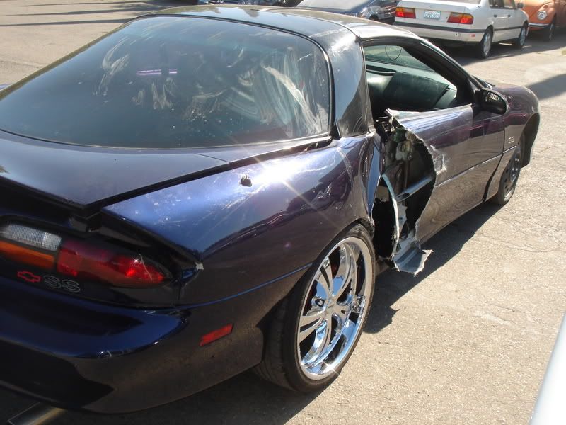

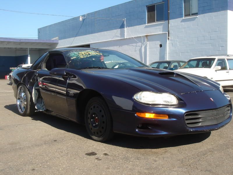

NAZ'SZO6 Posted May 14, 2007 Share Posted May 14, 2007 I have already started posting pics of my project in the members project section because I didnt know that people couldnt post any replies. I would like to know if people have anything to say. This is my first build so any; advice, criticism, etc is welcome. Plus I am starting on the LS1 part of my build because I just got my donor car so i will be posting here. 2001 Camaro SS M6. Is it easier to just pull this motor and trans from the bottom? Quote Link to comment Share on other sites More sharing options...

NAZ'SZO6 Posted May 15, 2007 Author Share Posted May 15, 2007 Sorry i dont know much about f-bodys but how much did you pick that smashed car for? I paid $4900 for it. Quote Link to comment Share on other sites More sharing options...
