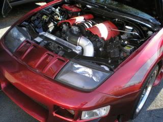

Whats up guys? I have'nt post on here in a long time but I figured I would get on here to and give you an update on my car. It has been running strong for a year now with no probs. I am very happy with the swap and would def recommend it to anyone who was considering. Here are a few pics of the car now with the new paint and wheels. Sorry the only motor pics I have are with the old paint...........
PB180173.jpg -This is the pic with the old paint
It actually took me about a about a year. However, the reason being was, I bought the motor while my Z was still running with the N/A motor. The LS1 motor sat in my my garage for like 6 months while I still researched more on the swap. I decided if I didnt go ahead and take the first step and take out the N/A motor, Then I would never get it done. So from the actual time it took from pulling the N/A motor to putting in the LS1 where it was drivable, it only took about 3 months.
