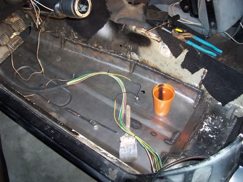

bobbyc Posted July 9, 2007 Share Posted July 9, 2007 here's mine...i just made it so it fit and could weld it up Quote Link to comment Share on other sites More sharing options...

Lighft01 Posted July 14, 2007 Author Share Posted July 14, 2007 Did you over lap the new with the existing any?? i seem you welded the entire seam. Is it better to do that or stitch weld it. A friend of mine swears up and down that stitch welding is better. I have a "450hp" LS6 going in it and i dont want to twist the car and the damn welds on the floor pan crack. Quote Link to comment Share on other sites More sharing options...
bobbyc Posted July 15, 2007 Share Posted July 15, 2007 it is good to stitch weld..weld a bit skip a section, weld some more skip and so on until you get it all welded solid...too much heat in a concentrated spot will warp it...i left a tiny bit of overlap..just cause trying to get the two to line up perfect and then weld is a major pita...i then hammered the back side down close and stitched the back..used some seam sealer for the areas between the welds. Quote Link to comment Share on other sites More sharing options...
