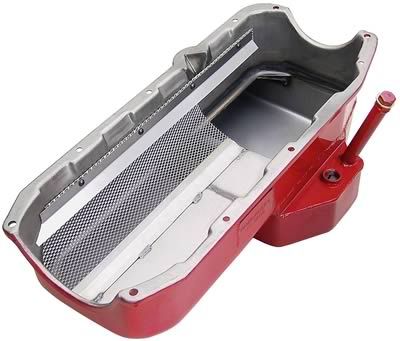

Administrators BRAAP Posted July 4, 2007 Administrators Share Posted July 4, 2007 Hamburger oil pans manufactures an inexpensive thick walled shallow oil pan with kick outs on both sides. Exactly 7” deep, holds 7 quarts, has built in crank scraper and trap door baffling. Clears the exhaust easily with the Hooker shorty headers. I used one on my first V-8 Z, a '75 280-Z, aka BRAAP.. That one I actually shorted the pan another ½” so it was 6 ½” deep, and added a piece a 1/8” sheet metal to the bottom of that for extra protection. This put the bottom of the oil pan at the same elevation as the bottom of the front cross member using the JTR engine mounts, (I did NOT use the JTR cross member spacers as that would’ve caused the oil pan to drag that much more). BRAAP was an autocross/street car and was lowered quite a bit and the OE V-8 oil pan was always dragging when coming off of speed bumps, no matter how slow I went over them, (remember, the sump of the SBC oil pan is behind the front wheels with JTR conversion), in the bottom of dips in the road, etc. I’d cringe real bad every time it drug, shut the engine off, stop and make sure it wasn’t leaking or didn’t collapse the pan enough to possibly be an issue covering the oil pickup. That is when I finally did the Hamburger pan shortened. You can’t shorten it much more than 6 ½” due to the oil pump, (unless you were running a remote oil pump such as dry sump…) Any how, I still drug the pan, but only on occasion and the extra material tacked to the bottom helped as the pan never distorted or collapsed. My current V-8 Z project, another SBC but with a blower this time around, is also getting a Hamburger pan, a new one and I have not shortened it, yet, and not sure if I even will this time around. Depends on which Z it goes into, (might end up in my Z-32) and depending on ground clearance. I’m not sure if Hamburger offers this pan for the one piece seal crank, though just because it isn’t listed say on Summits site, doesn’t mean they don’t offer it. Her is a link.. http://store.summitracing.com/partdetail.asp?autofilter=1&part=HAM%2D3037&N=700+400385+4294840045+115&autoview=sku My new Hamburger pan… Quote Link to comment Share on other sites More sharing options...

Administrators BRAAP Posted July 12, 2007 Administrators Share Posted July 12, 2007 Greg, First off, I didn’t see your response till just now. Sorry about that, I hope I’m not too late. That looks like a good find. Without the kick outs, you’ll have more room for your exhaust. The ad says he is supplying the pick up, so you shouldn’t need to get one. BTW, I just dug up the specs for your new pan. It is 7 qts, and 8†deep! One inch deeper than the other econo pans listed here. Is that going to be an issue for you ground clearance wise? Specs for Gvincents eBay find… http://store.summitracing.com/partdetail.asp?autofilter=1&part=HAM%2D1098&N=700+115&autoview=sku If you so choose in the future, or if this helps anyone else, here is a quick run down of the Hamburger shallow 7†deep, 7 quart oil pans for the SBC. The 3057 is for the ‘86+ one piece rear main seal SBC which includes the LT 1, (summit part number HAM-3057) All these pans are essentially the same in design and construction. Differences being which side of the block the dipstick is cast, and whether it is one piece or two piece rear main seal. Here are all three variants for this pan availed for the SBC. 3037, SBC ’80-’85 Pass side dipstick $229.95 http://store.summitracing.com/partdetail.asp?autofilter=1&part=HAM%2D3037&N=700+115&autoview=sku 3047, SBC ‘55-’79 Drv side dipstick $239.88 http://store.summitracing.com/partdetail.asp?autofilter=1&part=HAM%2D3047&N=700+115&autoview=sku 3057, SBC ’86 and later, one piece main seal. $223.69 http://store.summitracing.com/partdetail.asp?autofilter=1&part=HAM%2D3057&N=700+115&autoview=sku 3037 3047 3057 Quote Link to comment Share on other sites More sharing options...
gvincent Posted July 12, 2007 Author Share Posted July 12, 2007 Hi BRAAP, I have the pan and it is very clean and nice, I have the HV pick-up tube and have ordered a Melling HV pump as well, One thing the previous owner told me was to be careful with the dipstick, he had a problem with it clearing the crank scraper and inserted it wrong and ended up causing damage with the dipstick hitting the crank. On the Hamburger pans always use their 4 piece gasket especially with a stroker because notching a one piece Felpro always seems to leak and definately use the pan reinforcement bars. AS far as being too low, I guess I will find out once I get the motor installed () Anything special I need to know about swapping out the oil pump? Thanks, Greg Quote Link to comment Share on other sites More sharing options...
