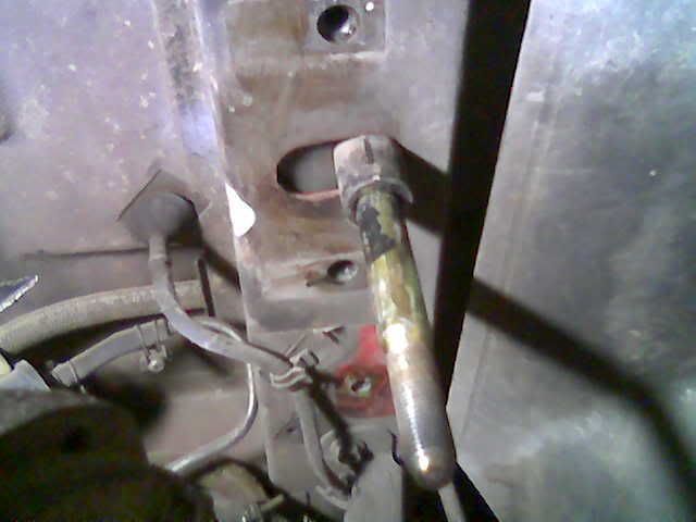

There are two things you will need to modify to get this to work. One is the rear diff mount - you just need to ream out the holes (dremel) so the mount will slide over the larger studs of the R200. IIRC, the threads are M10 x 1.00, compared to the R180's M8 x 1.00 studs.

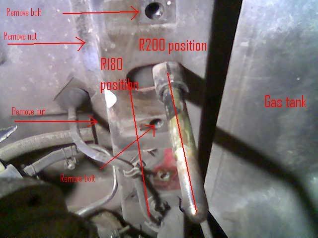

So, once the diff mount can slide over the studs, you'll find a new problem: the stud that slides vertically through the center of the mount is too far forward, and will not allow the rest of the bolts to line up. Then I noticed that the stud came out of a slotted hole, so it looked like I should be able to slide it. Actually, you have to flip it:
First I removed the two bolts and nuts (already removed) in the areas pointed out in this pic:

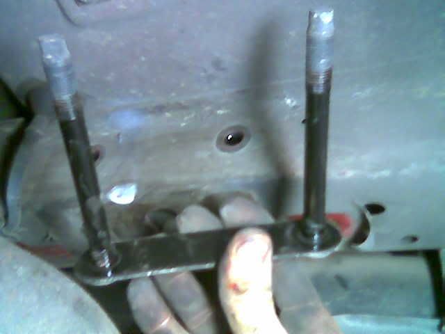

Then I lowered the gas tank a bit...enough to slide this out:
Once you slide the two bolts out, you will notice the stud is very loose. Now you need to get under the rear hatch carpet, where you'll see a black square pad glued down to the center area of the rear hatch. You need to remove the square, and then pull the block out that was underneath it (sorry, that was the best way I could think of describing it) - this block has the diff stud on it. Since the stud is offset in the block, simply flip it around and re-install it. Now the differential will be able to bolt up without any issues. I now realize I should've taken more pictures, so if you need me to draw anything else out or if you're confused about something, I can take some more pictures if necessary.
