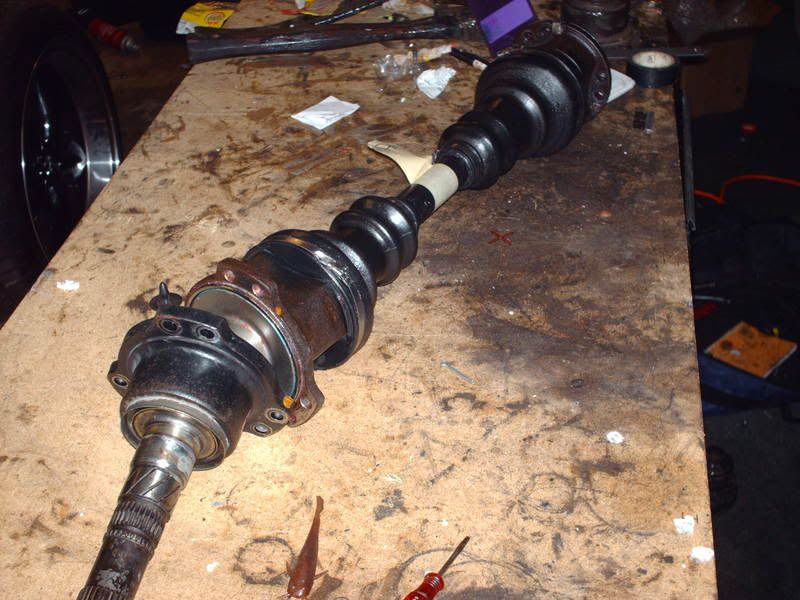

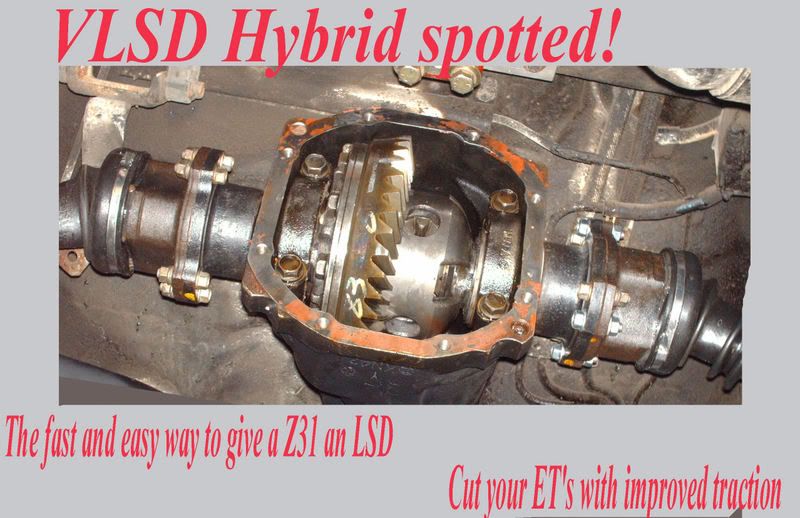

Racinjitter Posted August 13, 2007 Share Posted August 13, 2007 wongboh said: Sounds interesting... have you done this? Originally I was planning on buying the two sets of q45 cv's at the junk yard. Not with q45, but a j30, s13 and s14 with r200's. here are a few pics of other peoples setups... This is a tripod style. This is a DOB style. Quote Link to comment Share on other sites More sharing options...
