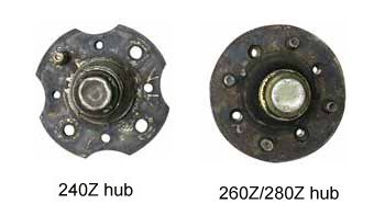

I have a set of Arizona Z brakes on their way. I am trying to obtain a set of 260z front hubs but I'm not real sure how you can differentiate them from the 240z hubs. I know there is a different offset but can somebody tell me what that is and how it's measured or if you can tell the difference just by looking? Thanks.
One thing I've found different visually is that the 240Z hubs are scalloped on the hub's outer circumference. In other words, the hub is not round like the later hubs, but instead squared off in the material around the studs by the lack of material between the studs.
