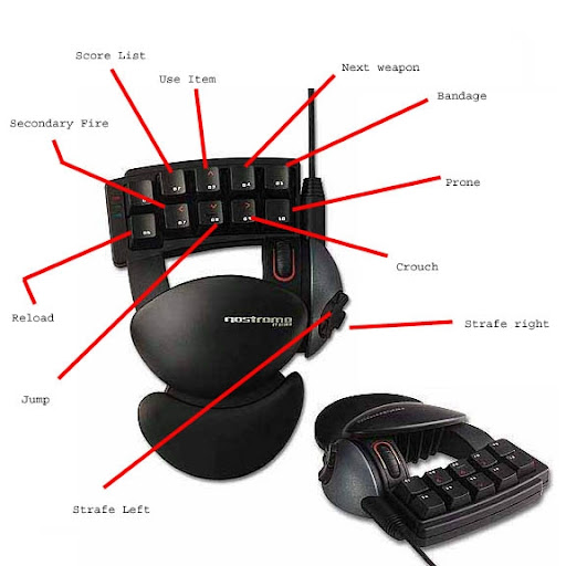

tannji Posted October 10, 2007 Share Posted October 10, 2007 Zmanco said: Although I like Matt's idea best, another approach is to drive with the tuning window open (TuningVE Table 1). At the moment you want to make an adjustment, press the "F" key which locate the cursor on the cell closest to the current settings being used. You can use a combination of "shift" and "up arrow" or "down arrow" to adjust the VE value on the fly. I find it a quick and dirty way to make near-real time adjustments while driving. But be careful not to take your eyes off the road. With laptop on the passenger seat, I can feel the keys without looking. I'd suggest practicing before going out on the road with other cars. I am planning on doing something similar, but with a Nostromo keypad strapped either to my knee or the console lid. It is an USB device that plugs in like a mouse or keyboard, and the 10 keys have 3 shift states, for a total of 40 or so total assigned keystrokes available to you, or a similar number of macros. (pre-recorded combinations of keystrokes, allowing a sequence of keys or commands to be enabled from a single keystroke) It also has a scroll-wheel, 8-way D-pad, and is form-fitted to your palm... very easy to train your hand to use. Those shift+arrow key combos could be a single keystroke, or even bound to up and down on the scroll-wheel or D-pad. As soon as I started looking into the Megasquirt manual in detail I thought it might be ideal for tuning on the go. Here is the basic setup, though it is an older version. Quote Link to comment Share on other sites More sharing options...
