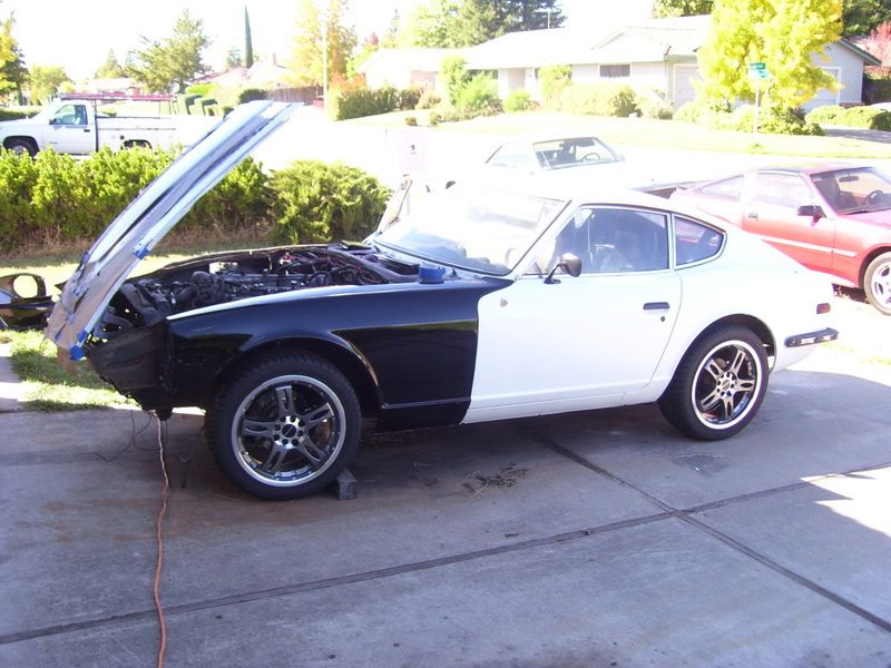

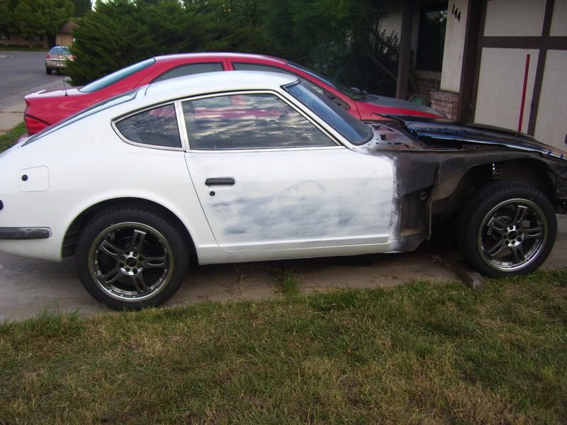

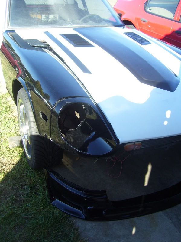

well ive been workin on the 240 a bit -

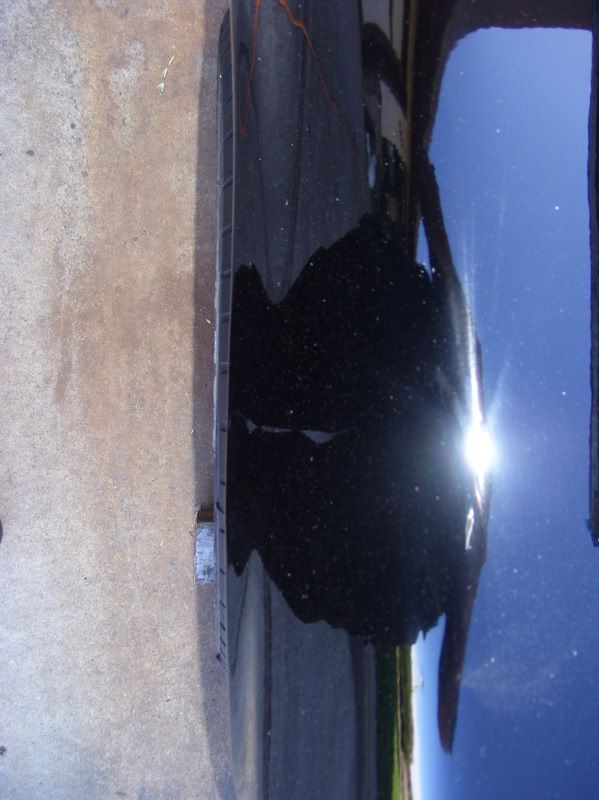

been painting - going white and black right now - still need to touch up some areas ( the door and all the chrome trim in black) but its deff a decent looker when rolling down the road i was surprised for spray can

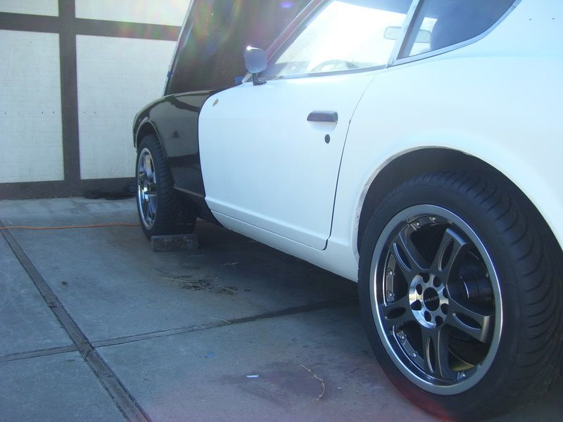

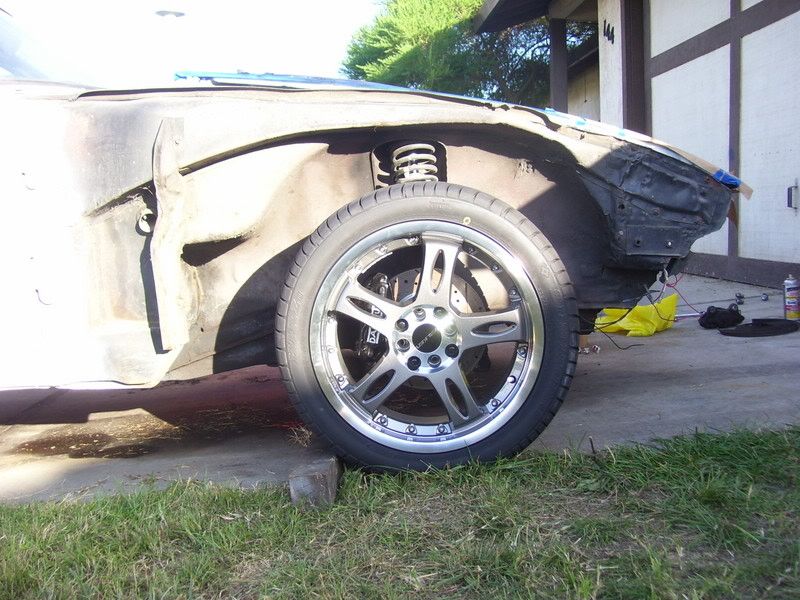

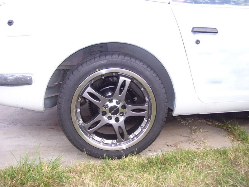

- added wheels an tires - i was trying to figure the right adapter with the right offset and all this garbage but no one would send me any pics of anything so heres this set up for future reference -
Wheels - falken sceptor fwd garbage 17x7.5 42mm offset
tires - sumitomo HTR Z 2 AA trac A temp 220 treadwear 225/45/17
Adapters - 4x4.5 to 4x4.5 1.5in

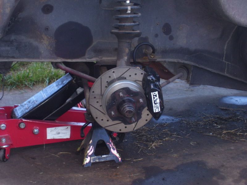

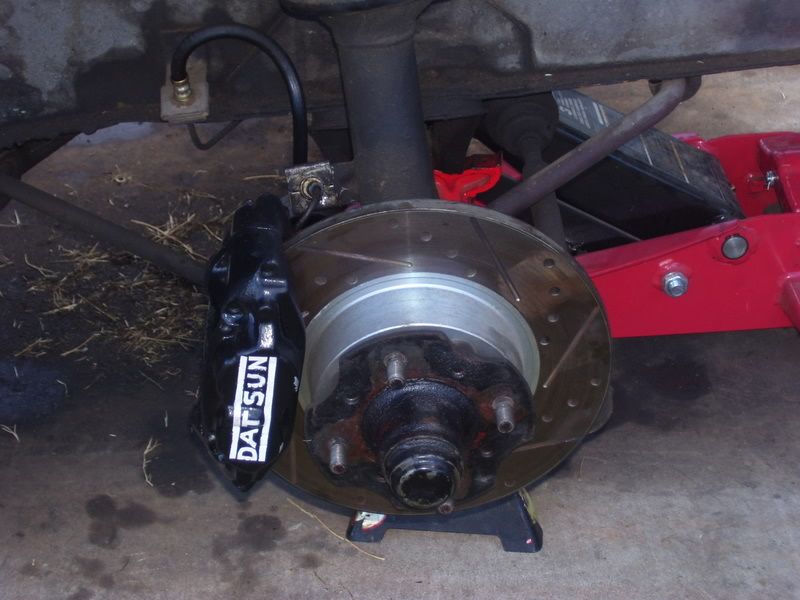

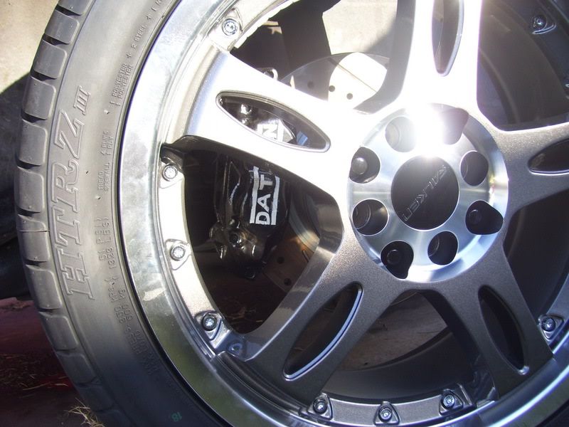

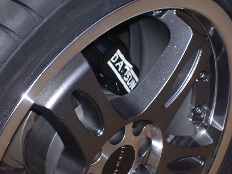

- also did the toyo 4x4 4 piston brake upgrade - super easy - looks good - and just sitting in my driveway the brakes allready feel 10973209327 times better -
Just unbolted the break line at the caliper unbolted the caliper. Popped the rotor hub assembly off checked bearing and greas condition removed the brake shield thing and popped the hub assembly back on. loaded the toyo 4 piston caliper with brand new porterfield R4-S pads bolted them on using the original bolts bent the brake line and reattached. Bled and all is good

heres how my week started
got them mounted and balanced - weights on the inside only - hate good lookin rims with weights on the outside
then to the brakes

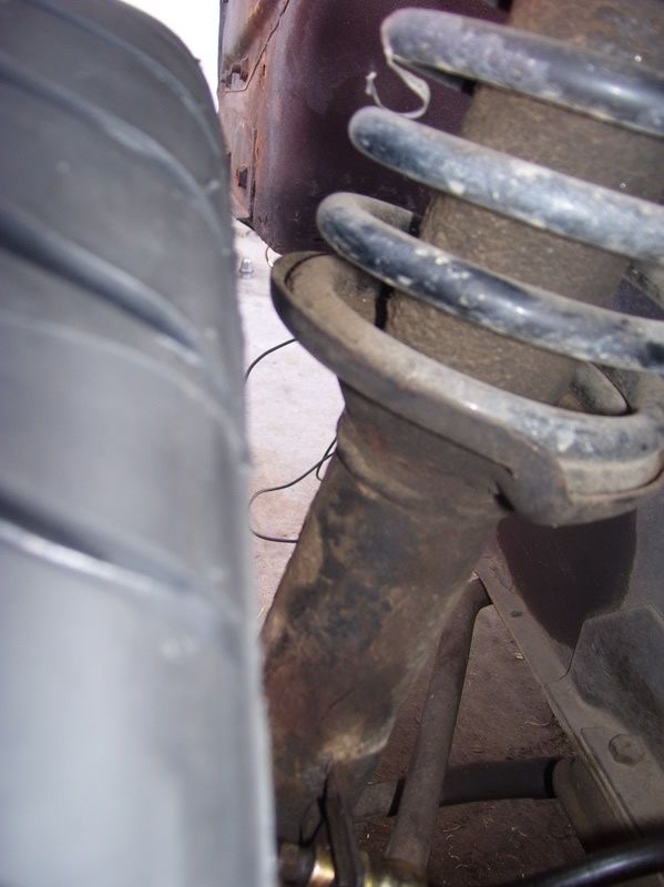

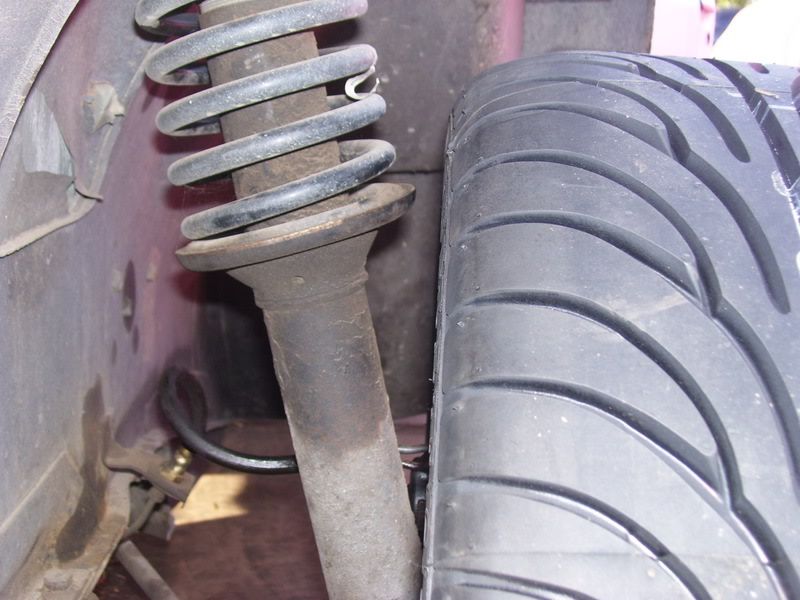

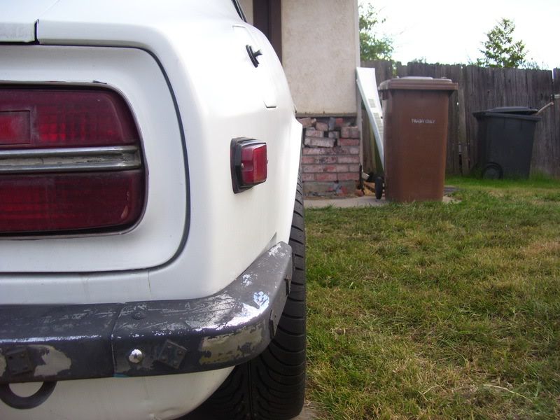

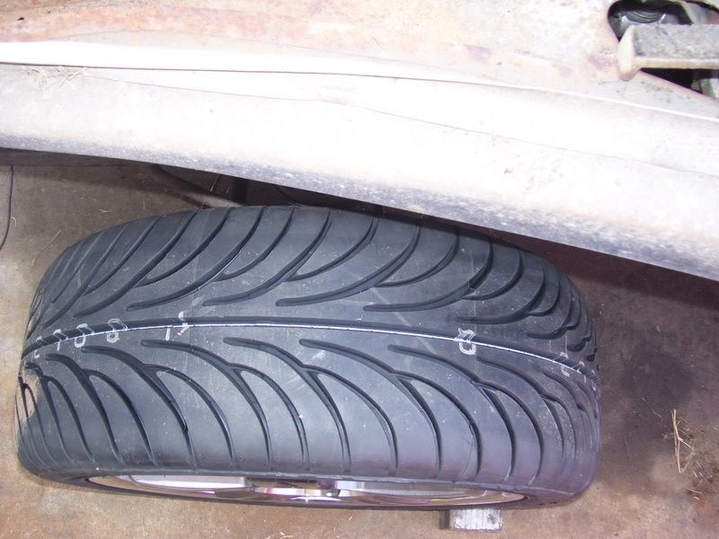

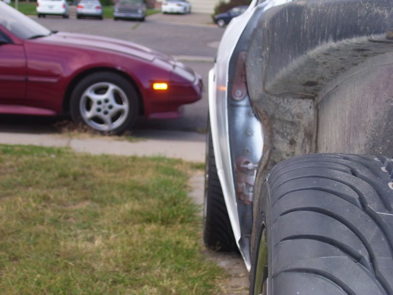

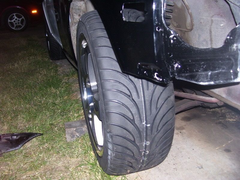

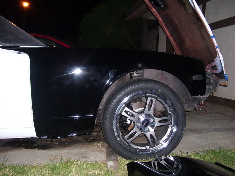

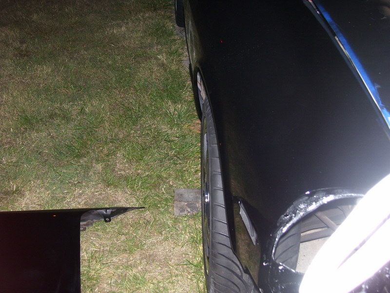

then wheels and tires - here are some clearance pics
Rear clearance
glad i got the 45 series but still need to lower it some - probably just wait and do some coil overs in a bit

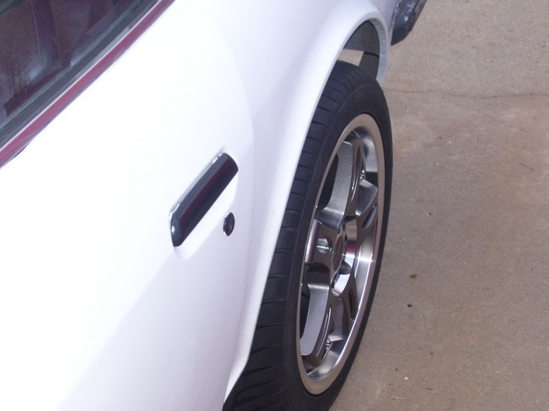

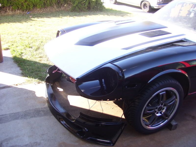

heres a few with the front fender just sat on there not fitted and bolted up

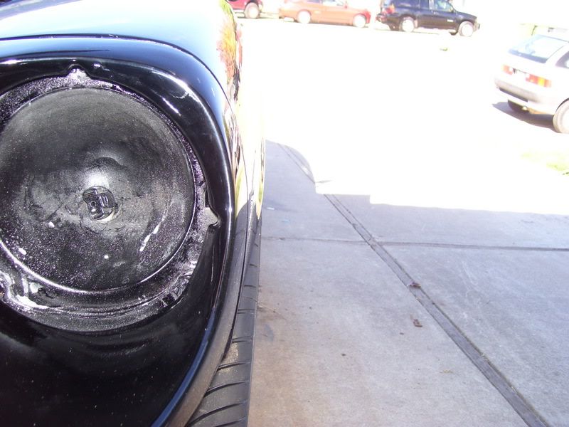

here are a few more pics of how the front wheel sits in the front fender and the hood ( i also have tinted headlight covers to put on)
wheel in front fender = just about perfect

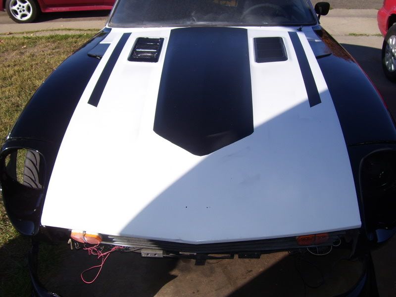

some of the hood - i need to redo a bit of it but like i said im just going for looking decent crusing down the road till i save up money for real paint and body
