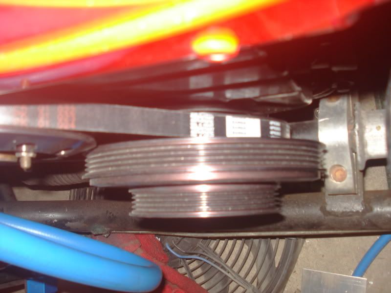

Well i went out and measured (roughly... very roughly) the size belt i was going to need for the ati 800hp damper. i went out and bought 4 different belts and the one that fits the best is the 4PK-0850
I think the 600hp damper is different so if anyone has it post what belt you used.
Water pump/ alternator
I may have seen it on here but the way to figure your belt size is to count the ribs ( 4 in my case ) and measure the diameter of the area where the belt goes. Then convert it to MM. In my case it ended up being a 4PK-0850
4 ( ribs) pk ( not sure) 0850 ( MM )
Hope this helps someone in the future :>
