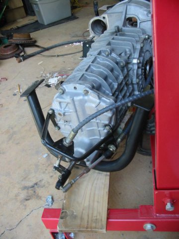

jt1 Posted December 18, 2007 Share Posted December 18, 2007 Ultima???? Post up some pics!!!!! If it's a rear engine car, I would use what I had, ie the darts. Skim them to true them up, use a steel shim head gasket to bump the comp some, and let it rip. You can tighten the ratios in a 930 trans, but like anything Pcar, it's pricey. John Quote Link to comment Share on other sites More sharing options...

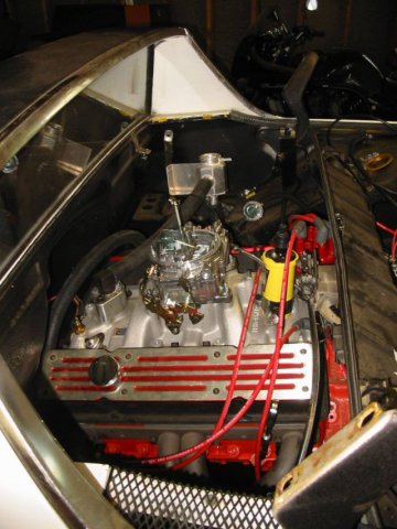

Guest terraview Posted December 19, 2007 Share Posted December 19, 2007 No not an Ultima It's a 914. I had the ring and pinion flipped in the 930 box. The 327 is a bit worn out so I bought a gmpp crate motor to replace it. And since I had the dart heads from another project that I sold, I figured I could save 50lbs and bolt them on a new short block. Don't have many pictures on this 'puter, but here's the 930 and cable shifter and engine. Ultima???? Post up some pics!!!!! If it's a rear engine car, I would use what I had, ie the darts. Skim them to true them up, use a steel shim head gasket to bump the comp some, and let it rip. You can tighten the ratios in a 930 trans, but like anything Pcar, it's pricey. John Quote Link to comment Share on other sites More sharing options...

jt1 Posted December 21, 2007 Share Posted December 21, 2007 V8 914's are max cool cars. A friend used to have one with a 302. It was a real terror, but stayed broke a lot. I'm pretty sure he was using a 901 trans. What's this thing gonna weigh, 21-2200#? It's going to be a ball to drive, for sure. John Quote Link to comment Share on other sites More sharing options...
