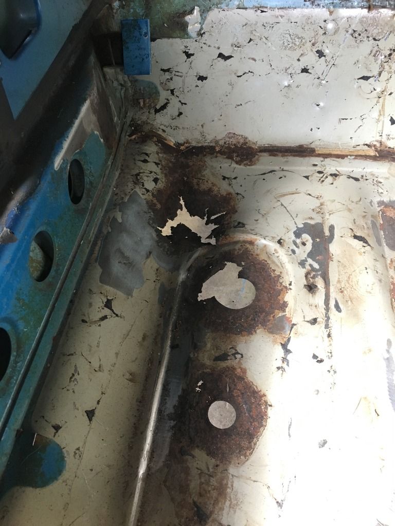

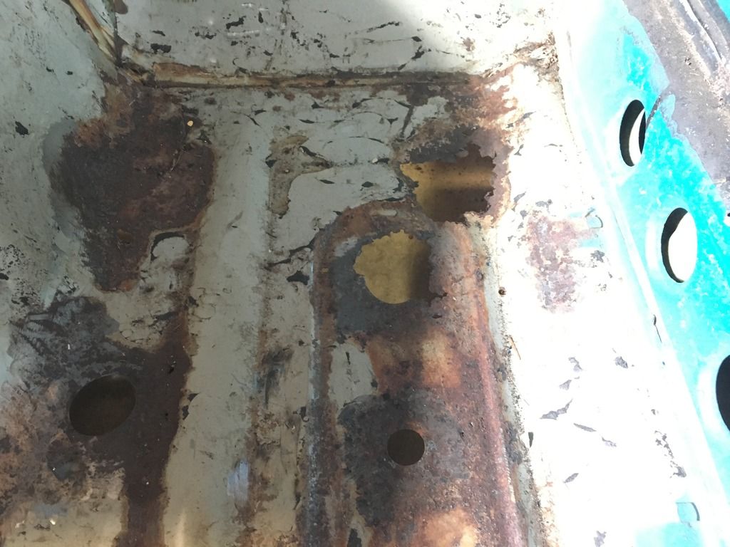

X64v Posted December 15, 2015 Author Share Posted December 15, 2015 Been slowly working on the car, a few hours here, a few hours there. Seats out: Dashboard and windshield out, they were surprisingly easy: Removing the tar mat sound deadening was by far the most time-consuming part of stripping the interior. I removed about half of it with a paint scraper and hammer, the rest I used dry ice on to make it brittle and then chipped it off with an old screw driver: The rust on the driver's side floor pan didn't turn out to be as bad as I thought it would be, I'm hoping to be able to get away with two or three patches and then wire wheel/rust convert the rest of it. The passenger side, however, turned out to be a little worse. The battery tray rust has not only eaten through the inner fender, but also about a 5" section of the firewall, and the floor pan has various rust all the way back to the front seat rail. I'll decide how to deal with it after I clean up the metal and see the full extent of the damage. Prevailing opinion is that replacing the whole pan is easier than many small patches but I'm really trying to avoid that if I can. I'll post some more detail shots soon. Quote Link to comment Share on other sites More sharing options...

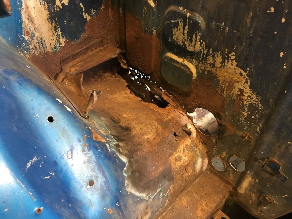

X64v Posted June 13, 2016 Author Share Posted June 13, 2016 Front of the car disassembled: I'm not sure about how to go about cleaning all this up. I'm guessing a wire wheel to most of it and an angle grinder for the surface rust will be one of my only options without media blasting. I'm also considering removing all the flexible wire keepers attached to the sheet metal in favor of a real fastener system for engine bay organization. Better view of the rust underneath the battery tray: It's eaten through the firewall into the passenger compartment: Will be a tricky area to repair, I'm going to save it until I'm practiced up. First areas will be the floor pans: Pulled the gas tank, inside looked like this: I trashed it immediately. At the moment I'm planning on going with a cheap fuel-cell-style tank from summit, it won't be a proper cell but this car is realistically only gonna see street and autocross use for quite a long time. Quote Link to comment Share on other sites More sharing options...

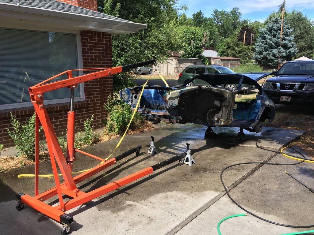

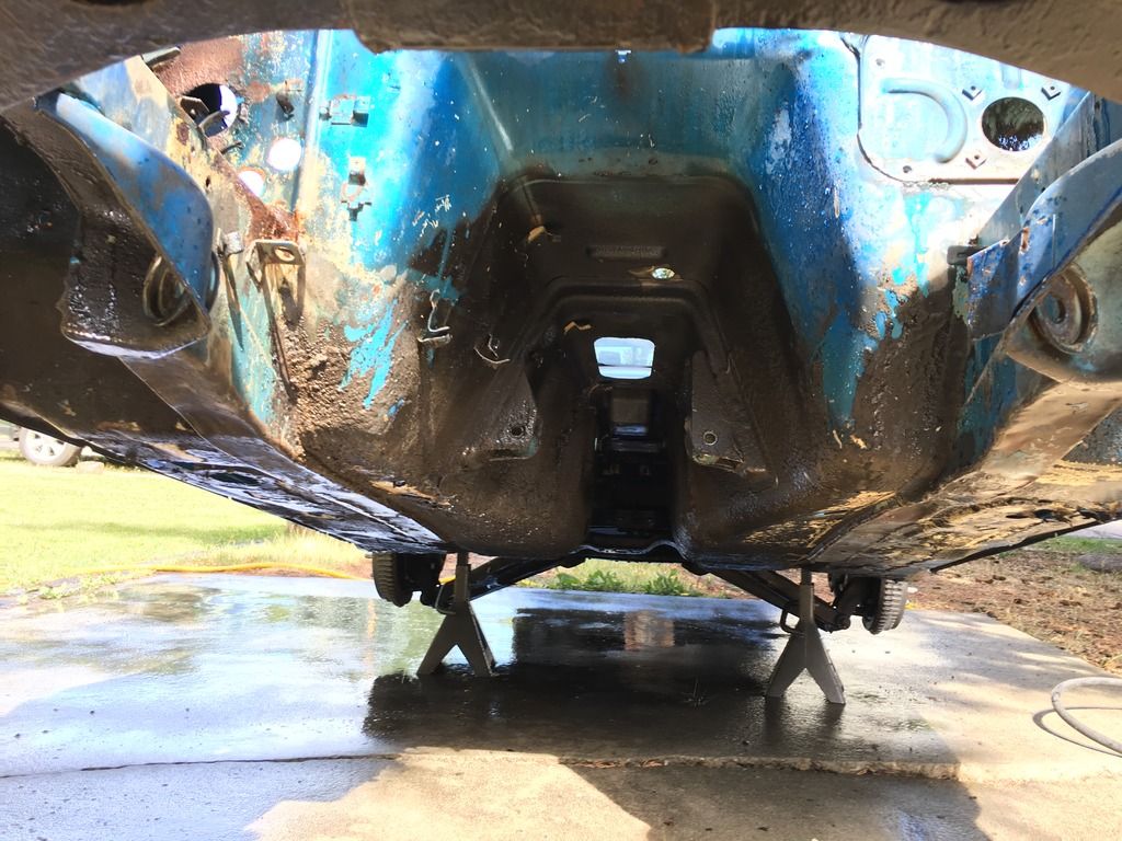

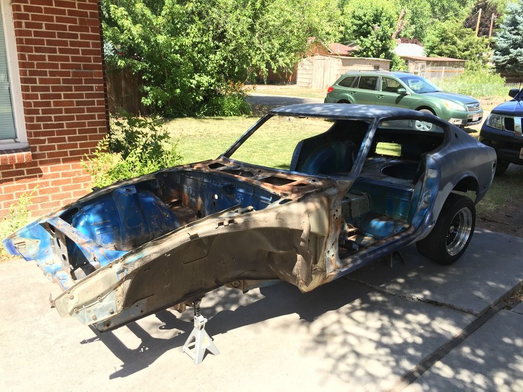

X64v Posted February 19, 2017 Author Share Posted February 19, 2017 (edited) It's been a long busy summer and an unusually cold and brutal winter here in southwestern Idaho, but I'm slowly making some progress. Last summer I borrowed a co-worker's 3500PSI pressure washer and blasted all the grease, oil, and road grime off the shell as best I could: Mid-progress pic, making my way down the firewall and into the trans tunnel. Incredible difference: Slightly visible in the pic above, the floor pans and frame rails are arched upwards from the front of the floor pan back to the front seat brackets, probably from a hard wack on a speed bump at some point in the car's life (I swear it wasn't me). Other than being a bit dented up, the frame rails and floor pans are generally fine, and I think I'm going to try to save them by straightening them as best I can and patching what holes the floor pans do have. I think a slide hammer, a dead blow mallet, and a block of wood should do the trick of getting them mostly true. From the front seat brackets back to the rear subframe the pans are straight and solid, so I'm going to add Bad Dog rear subframe connectors and tie them into the stock rails. At some point in the future I may add full Bad Dog rails and do more work on the pans, but this isn't a show car so I'm not worried about re-doing any paint or undercoating. Here are some better pics of the floor pan and battery tray rust: I knew my hatch had rusted in the window channel, but today I finally removed the glass and found out exactly how much: I'll cut the rust out of the outer shell and see how much of the frame underneath is damaged. Edited February 19, 2017 by X64v Quote Link to comment Share on other sites More sharing options...
