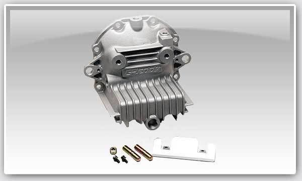

Guest 280ZForce Posted March 5, 2008 Share Posted March 5, 2008 I'm trying to find a finned cover for my r200 clsd i got from a 87 300zxt. I sold the cover couple years back in order to use the stock cover mount and I needed the money. Now I have a mount for clearing the finned cover, I can special order one from the dealer, but I've also been looking at the GReddy r200 finned cover, which increase the capacity of oil by 0.7L (900cc)... BUT.... my question is do all r200 cover bolt up around the outside edges of the cover the same in order for me to use this cover? I can deal w/ the middle spacing being different. GReddy says they have r200 finned covers for: 14520401 1994 - 1998 Nissan 200SX (Non-US) (S14) L4 2.0L SR20DET 2000 - 2002 Nissan 200SX (Non-US) (S15) L4 2.0L SR20DET 1995 - 1998 Nissan 240SX (S14) L4 2.4L KA24DE 1994 - 1998 Nissan Silvia all trims 1999 - 2002 Nissan Silvia all trims Thanks - Justin Quote Link to comment Share on other sites More sharing options...

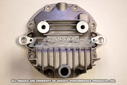

RB26powered74zcar Posted March 6, 2008 Share Posted March 6, 2008 Here is the Greddy knock off I have... click Quote Link to comment Share on other sites More sharing options...
Mr.INSANE Posted March 6, 2008 Share Posted March 6, 2008 First time I've seen one of those diff cover's They look pretty nice although It would be nice if they had some oil return/feed nipples built on them for installing an diff cooling system Quote Link to comment Share on other sites More sharing options...
RB26powered74zcar Posted March 6, 2008 Share Posted March 6, 2008 Mr.INSANE said: First time I've seen one of those diff cover's They look pretty nice although It would be nice if they had some oil return/feed nipples built on them for installing an diff cooling system I hear you, but that could be solved easily... have some alum AN bungs welded on... Or, I guess the bottom hole could be used for supply, and the top port for return... Quote Link to comment Share on other sites More sharing options...
Guest 280ZForce Posted March 6, 2008 Share Posted March 6, 2008 Mr.INSANE said: First time I've seen one of those diff cover's They look pretty nice although It would be nice if they had some oil return/feed nipples built on them for installing an diff cooling system The GReddy unit comes w/ an integrated 3/8" pt port that can be used for external coolers. Quote Link to comment Share on other sites More sharing options...
