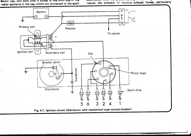

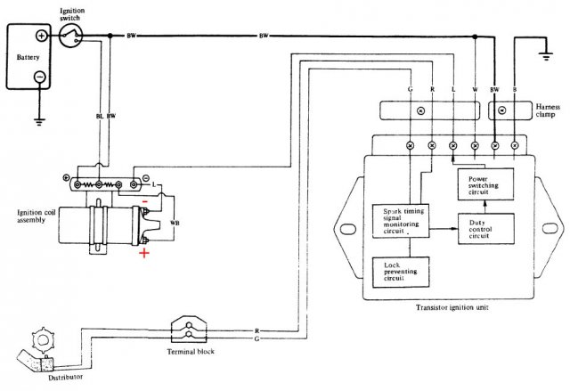

DatsunD Posted March 13, 2008 Share Posted March 13, 2008 #1 image is Ignition Circuit (distributor with mechanical type contact breaker) #2 image is ignition circuit (transistor type distributor) Look what i found, let me know if it helps. Quote Link to comment Share on other sites More sharing options...
TrumpetRhapsody Posted March 13, 2008 Author Share Posted March 13, 2008 Oooh those are nice, thanks! The #1 appears to be for a 240z early setup, simple in and out resistor. The #2 seems to be right on the money. It does indeed look like the center pin is meant to bypass the resistor when starting (like i've read and people have told me, lol). So I should just be able to connect the two ends, leave the middle unhooked, and it should run fine (until I burn up my points or coil). Feel free to test that theory for me , j/k. That also tells me that I need to make sure I have the right type of dizzy in there (transistor type), which I think I do. w00t Quote Link to comment Share on other sites More sharing options...

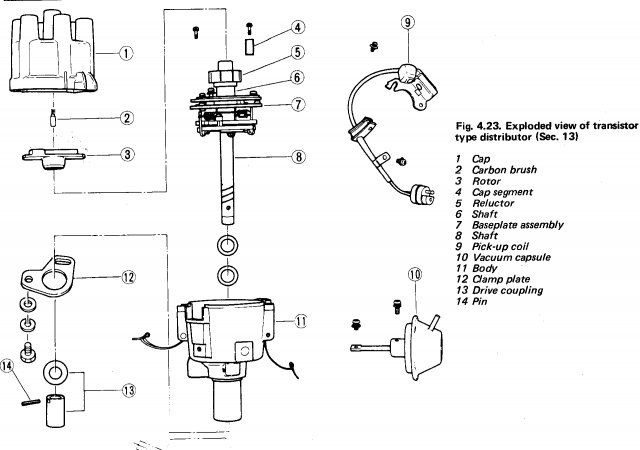

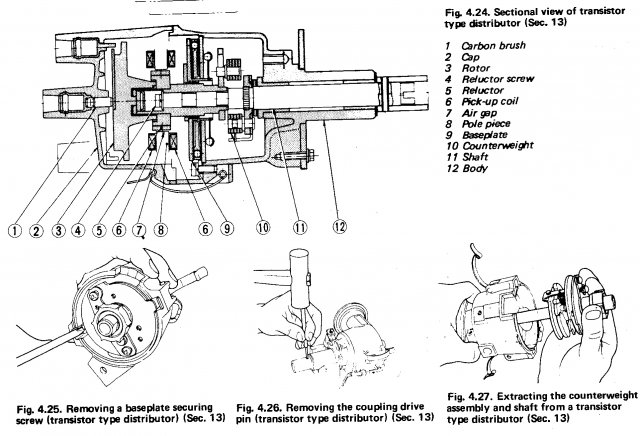

DatsunD Posted March 13, 2008 Share Posted March 13, 2008 I have a an exploded view of the transistor type dizzy would that help? Quote Link to comment Share on other sites More sharing options...

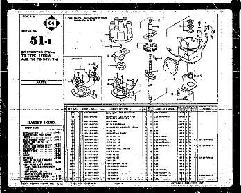

TrumpetRhapsody Posted March 13, 2008 Author Share Posted March 13, 2008 This one? From the fiche? Quote Link to comment Share on other sites More sharing options...

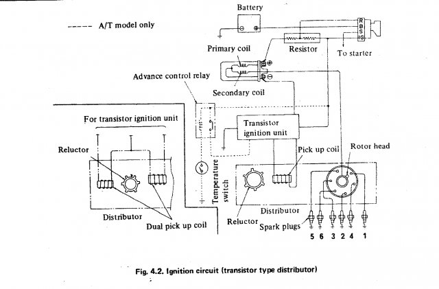

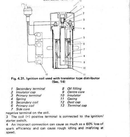

DatsunD Posted March 13, 2008 Share Posted March 13, 2008 I have the haynes manuel diagrams. Quote Link to comment Share on other sites More sharing options...
TrumpetRhapsody Posted March 13, 2008 Author Share Posted March 13, 2008 Sure, couldn't hurt if you don't mind! Quote Link to comment Share on other sites More sharing options...
DatsunD Posted March 15, 2008 Share Posted March 15, 2008 Sorry it took me a while to post these but here they are. Let me know how it turned out for you. Quote Link to comment Share on other sites More sharing options...
TrumpetRhapsody Posted March 16, 2008 Author Share Posted March 16, 2008 I tried bridging both the outer and middle wires to the inner wire (to the coil), and here's what happened: Middle: Have spark will cranking (START position), but stops giving spark when returned to ON position. Outer: Have spark while in ON position (and engine is turning), but none whle cranking (START position). So as it is right now, I only can get it to run by keeping it in START for a few seconds, then having it catch and fire when returning to the ON position. Needless to say, it doesn't work every time. Quote Link to comment Share on other sites More sharing options...
