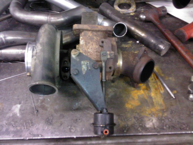

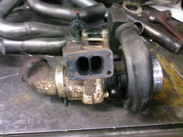

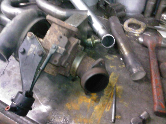

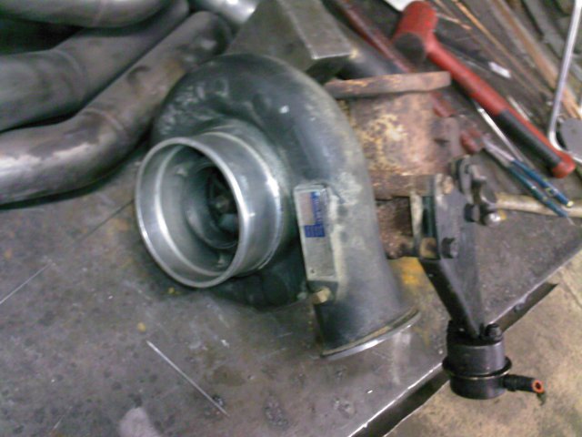

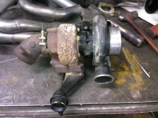

cholag Posted September 25, 2008 Author Share Posted September 25, 2008 Sorry about the long wait but I hope these pictures help you out, my friends dad who welded it told me, it was quite the job he had to heat the manifold weld a little bit, then heat again then weld again, but he did say that it was cracking a little but he was able to fix and save the manifold. Also the paint is not a grey primer, its header paint the weld started to rust so I lightly wire wheeled it then just sprayed it. Also there is a couple pics of it mounted to the motor, I finished the motor a couple months ago and I am real close to dropping her in, I cant wait! Quote Link to comment Share on other sites More sharing options...
djbit Posted September 26, 2008 Share Posted September 26, 2008 Wow, that looks great! Thanks for posting the pics! Did you have to clock the turbo? Mine faces down and I kind of want it to face towards the drivers wheel panel like yours. Let us know if you have any fitting issues with the waste gate or the turbo hitting the chassis or drive wheel column thingy. Quote Link to comment Share on other sites More sharing options...
