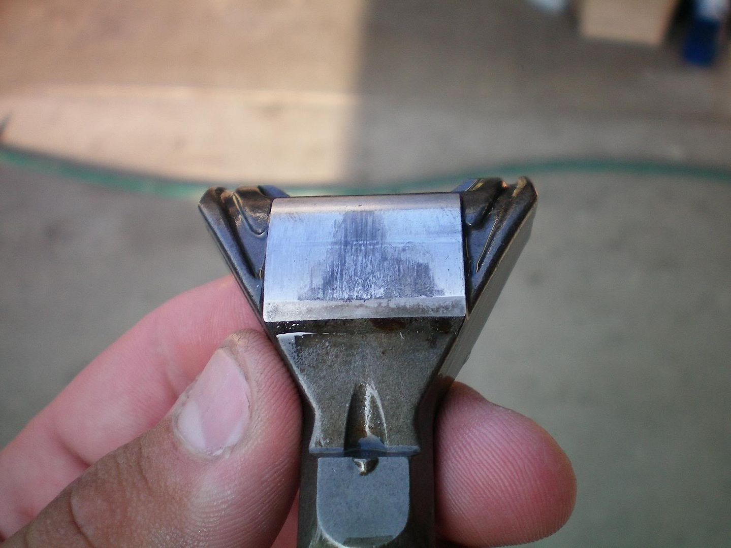

280zjoel Posted April 9, 2008 Share Posted April 9, 2008 Hi everyone, just like to say i got my z back from vildinimotorsports were they did a great job on my car, Im completely satisfied with the work they have done, but i screwed up on the head gasket (no copper spray on MHG) and it leaks:malebitch. But to get to the point, here is my issue, while in the process of removing the cylinder head i noticed that one of the rocker arm has some scouring marks on it, i know it wasn't there before but i am wondering what caused it, do you guys think i have a bad lifter, or maybe something i overlooked? either way i got a spare block and head for parts so i can just swap the rocker arm and hydro lifter over but im not sure what the problem might be. thanks in advance Quote Link to comment Share on other sites More sharing options...
Projekt sixSTAR Posted April 9, 2008 Share Posted April 9, 2008 i think that's normal because some of my rocker arms look like that when i took apart my sr. Quote Link to comment Share on other sites More sharing options...
steveosupremeo Posted April 25, 2008 Share Posted April 25, 2008 can you feel the marks with your fingernail? if so i'd polish it with some fine grit sandpaper. Quote Link to comment Share on other sites More sharing options...
logr Posted April 26, 2008 Share Posted April 26, 2008 That is NOT normal. I would check them all very closely. It is usually caused from no oil on that lobe. Check the oil holes in the tubes that lube the cams. I always soak the pipes in carb cleaner and blow them clear. You should also check the cams. The rockers should be smooth with no wear lines on them, otherwise, replace them. Quote Link to comment Share on other sites More sharing options...
