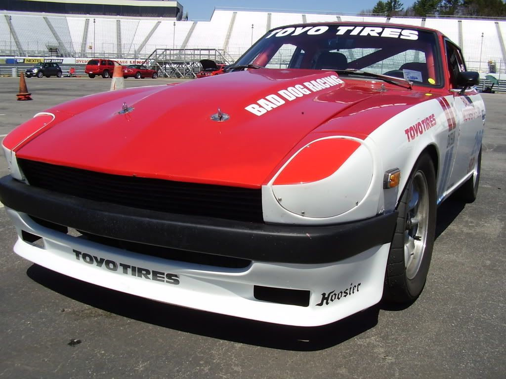

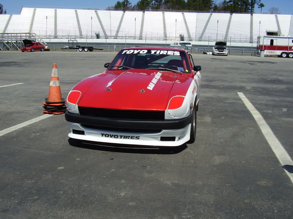

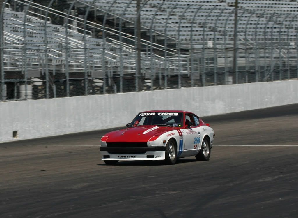

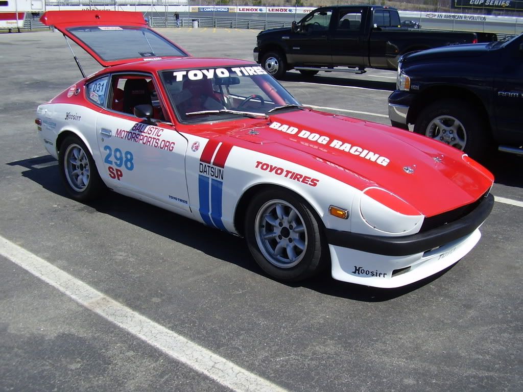

Bad dog has a new lower stance:
New camber plates installed this winter. Lower ride height. Corner balanced within 100lbs or so.
Setup (per John Coffeys recommendations):
I'm running 225-50ZR15 tires:
Front:
Camber: 3.1 neg
Toe: 1/8" out
Ride height: 5 1/2"
Rear:
Camber: 2.5 neg
Toe: 1/8" in
Ride height: 5 3/4"
I played around with the Tokico HTS strut damping, but didn't really notice much difference. I've got them set 3 turns out now. Front springs are 375lb, rears are 350lb
Car turns much better. The event I did Friday was just a practice day. I'll have to wait until the next time trial event to see if I am in fact going faster :mrgreen:
