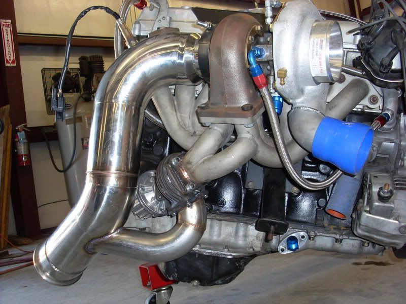

Actually, the internals of the GE and GTE arequally as strong (and both use cast pistons). The GE head has smaller intake ports and larger exhaust ports (opposite of what you need for a turbo setup) so they typically don't make as much power as the GTE, but for $300 I couldn't say no to the GE. I have a Boostlogic NA-T kit, and it fits beautifully. I had to slightly modify the downpipe and fab intercooler pipes, but everything else was bolt-on.

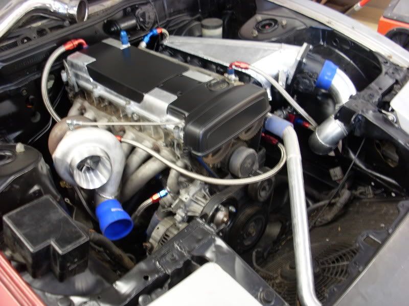

I get the transmission back tomorrow, so it should be running by this weekend. Having access to all of boostlogic's and performance motorsports' tools, lifts, and fabrication equipment has been a blessing. I started the project less than a month ago, and I have been stuck for two weeks waiting on the transmission. I have a few wiring odds and ends, a driveshaft has to be made, exhaust system, transmission lines, and a few minor tasks left to do. If I would have had all the parts from the begining, I think I could have done it from start to finish in 28 days, all while working my normal job 10-6 M-F.

Read his post again - they BOTH use CAST pistons. Also, you'll find going turbo with a GE motor won't be much cheaper, if at all, versus just using the GTE engine. One big reason is the GE intake manifold won't fit under your stock hood so you'll have to do something with that. Custom GE intakes run from $1000-$2500. Streetfighter built his own. Also, you're guaranteed to have to get a custom header to mount a turbo and all the costs associated with the plumbing. You'll also have to use the distributor from the GE or figure out what you wanna do about bypassing it.

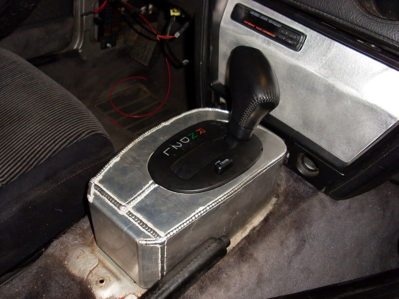

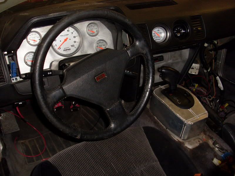

Exhaust is done, shifter linkage and housing is done, wiring is 90% complete, there is not much left. I still have to modify the center arm rest to fit the supra shifter, run some transmission cooler lines, do a bit more wiring, and get a driveshaft made... but that's pretty much it. 4 inch exhaust is stupid huge.
That is very pretty work, StreetFighter - I was proud of my custom intake until I saw that beauty of yours. Thanks for making me feel inadequate!:mrgreen:

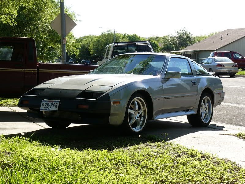

That's a pretty wild Z you have there... I'd love to see what the 2JZ looks like in there. Was it SBC powered before? I see some chevy exhaust gaskets on the floor.
I don't have a speedo. This is a weekend warrior car, so I figured I didn't really need it.

Yep, it had a 468ci sbc before.

That's some really nice looking work that you've done on your car. Looks very professional.:icon14:
If the trans temp gauge reads hot I'll wrap it, but I think the airflow under the car should help with keeping the trans cool, and at a stop, the exhaust really isn't terribly hot.
