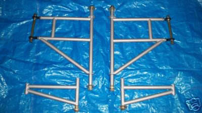

Dat260 Posted April 23, 2008 Share Posted April 23, 2008 Hi Guys, Can anyboby comment on these "old school chrome moly control arms". Are they Nissan product or home made. I have never seen this design before, they are new never installed. Thanks, Quote Link to comment Share on other sites More sharing options...
blueovalz Posted April 23, 2008 Share Posted April 23, 2008 Judging from the photos, I'd guess home-made products here. I don't know of any factory supported pieces like this. Interesting front arm design. First time I've seen one quite like that. Quote Link to comment Share on other sites More sharing options...
JMortensen Posted April 23, 2008 Share Posted April 23, 2008 I may be totally wrong, but I'm thinking that about 15 years ago ArizonaZCar's arms might have looked something like this. This is back in the day when he sold a full tube frame chassis and 12" Wilwood brakes that were for "Z's that regularly see 200+ mph". Quote Link to comment Share on other sites More sharing options...
Dat260 Posted April 23, 2008 Author Share Posted April 23, 2008 Thanks for your input guys and keep them coming. Jon are sure they were ArizonaZ's design? Maybe I should contact Dave. I need to know what balljoint to use. I just purchased them through Ebay and the owner had them for a long time but never used them. Terry, your car is still #1 on my list. Cheers, Quote Link to comment Share on other sites More sharing options...
JMortensen Posted April 23, 2008 Share Posted April 23, 2008 Dat260 said: Thanks for your input guys and keep them coming. Jon are sure they were ArizonaZ's design? Maybe I should contact Dave. I need to know what balljoint to use.I just purchased them through Ebay and the owner had them for a long time but never used them. Terry, your car is still #1 on my list. Cheers, No, I'm not sure at all that those are AZC products, which is why I said "I may be totally wrong...". I think you can find out what the ball joint is on the Arizona Z Car arms by searching. I know it has come up before, and it seems to me it was a tie rod end from a 3/4 ton Ford truck or something. Quote Link to comment Share on other sites More sharing options...
Dat260 Posted April 23, 2008 Author Share Posted April 23, 2008 Thanks Jon, I just pm Dave hopefully he will have an input. Cheers, Quote Link to comment Share on other sites More sharing options...
arizonazcar Posted April 23, 2008 Share Posted April 23, 2008 These are (or look like) the same set of arms that have been passed back and forth at least a dozen times over the years, I believe they were mock-up pieces that I threw away years ago and someone scavenged out of the trash (i know who). They are not Chromoly and were never intended for actuall use. I'm sure we'll see em another dozen times before someone finally throws them away. Dave Quote Link to comment Share on other sites More sharing options...
Dat260 Posted April 23, 2008 Author Share Posted April 23, 2008 arizonazcar said: These are (or look like) the same set of arms that have been passed back and forth at least a dozen times over the years, I believe they were mock-up pieces that I threw away years ago and someone scavenged out of the trash(i know who). They are not Chromoly and were never intended for actuall use. I'm sure we'll see em another dozen times before someone finally throws them away. Dave Therefore not safe to use for street and/or occasional track? Quote Link to comment Share on other sites More sharing options...
arizonazcar Posted April 23, 2008 Share Posted April 23, 2008 Not Safe For Any Use Of Any Kind!!! Quote Link to comment Share on other sites More sharing options...
