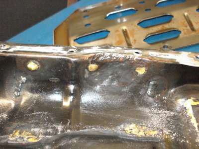

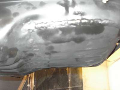

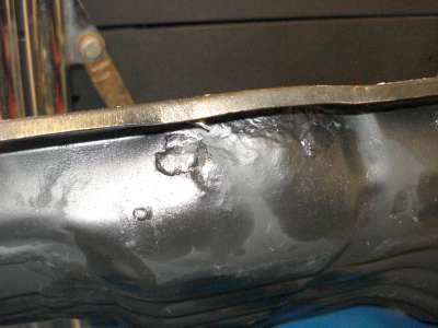

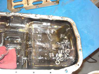

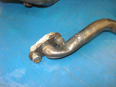

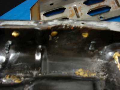

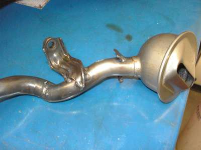

stony Posted April 25, 2008 Share Posted April 25, 2008 Well here are my pan and pickup. Its a modified, z31 rb20 pan, and the pickup is a cut and welded rb20 and rb25 contraption. Quote Link to comment Share on other sites More sharing options...

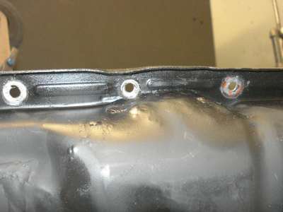

stony Posted April 25, 2008 Author Share Posted April 25, 2008 nevermind all the little pieces of metal:icon56: You can see the forward area of the pan where i had to cut reshape and weld back together to clear the windage tray. Quote Link to comment Share on other sites More sharing options...
mattyice Posted April 25, 2008 Share Posted April 25, 2008 i think i might just end up doing this so that i can clear the windage trays as well but go external pickup Quote Link to comment Share on other sites More sharing options...
